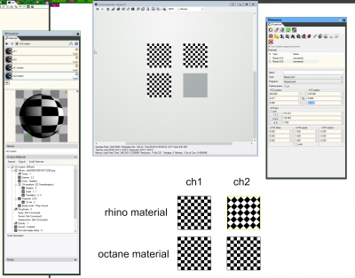

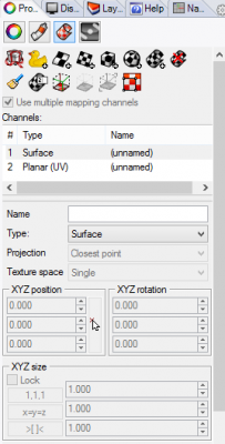

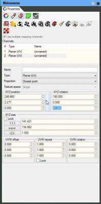

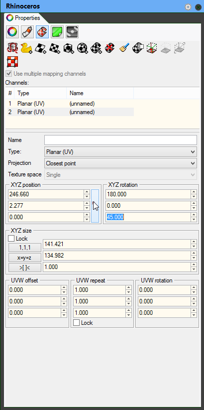

Hi Paul,
I attatched another scene with two screenshots.
you are right the version i sent last time accidentally had the same custom projector in both channels, however it is not important in that problem i think.
in the new file it is a simple plane, it has surface map plus 45 rotated planar projector. but whatever I do I can not get the second channel to work, if inside the octane material i activate anything other than channel 1 I get no output in the texture channel(bump, normal,etc). it looks like map average plus bordermode color.
it is tough for me as it stops my current project where i have to use 2 mappings, 1 to assign different tile colours(texture pixels) to hundreds of objects within a single material and 2 to control the bump and displacement in real scale.
would you know any way to get the two uv maps out of rhino to standalone in some way,
meaning is there anyway I could add the two uv sets to one object in the node editor?
thanks!
daniel
thanks!
daniel

Hi - I am really sorry, but I cannot understand what you are trying to do here. If I render that scene with the Rhino render, I am not seeing two sets of UV's - it just renders with one. If you can set this scene up with a Rhino Material using the two channels, I can take a closer look.
EDIT: The simple solution to your issue is to split the mesh into two - one for each texture mapping channel, and assign a different Octane Material to each of the two meshes.

Hi Paul,
i am not in the office anymore, but could you please try the following:
create a material with eg. a checker texture and assign it to the diffuse slot in an octane diffuse material.
and assign this material to the plane in the last file I uploaded.
there are two channels(surface and planar) visible in the object properties. (planar is 45° rotated so that channel should render visually differently when using stripes,squares and such)
If I start the render, and the go into the UV projection properties of the diffuse texture, and set it to UV set "2" i do not see the 45° rotated diffuse map, but only a single colour.
I hope like that you can see it too!
cheers
daniel

I am really sorry - but you will need to send me a Rhino file which clearly demonstrates the problem, and I will take a closer look.

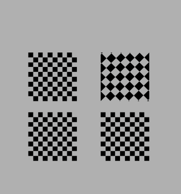

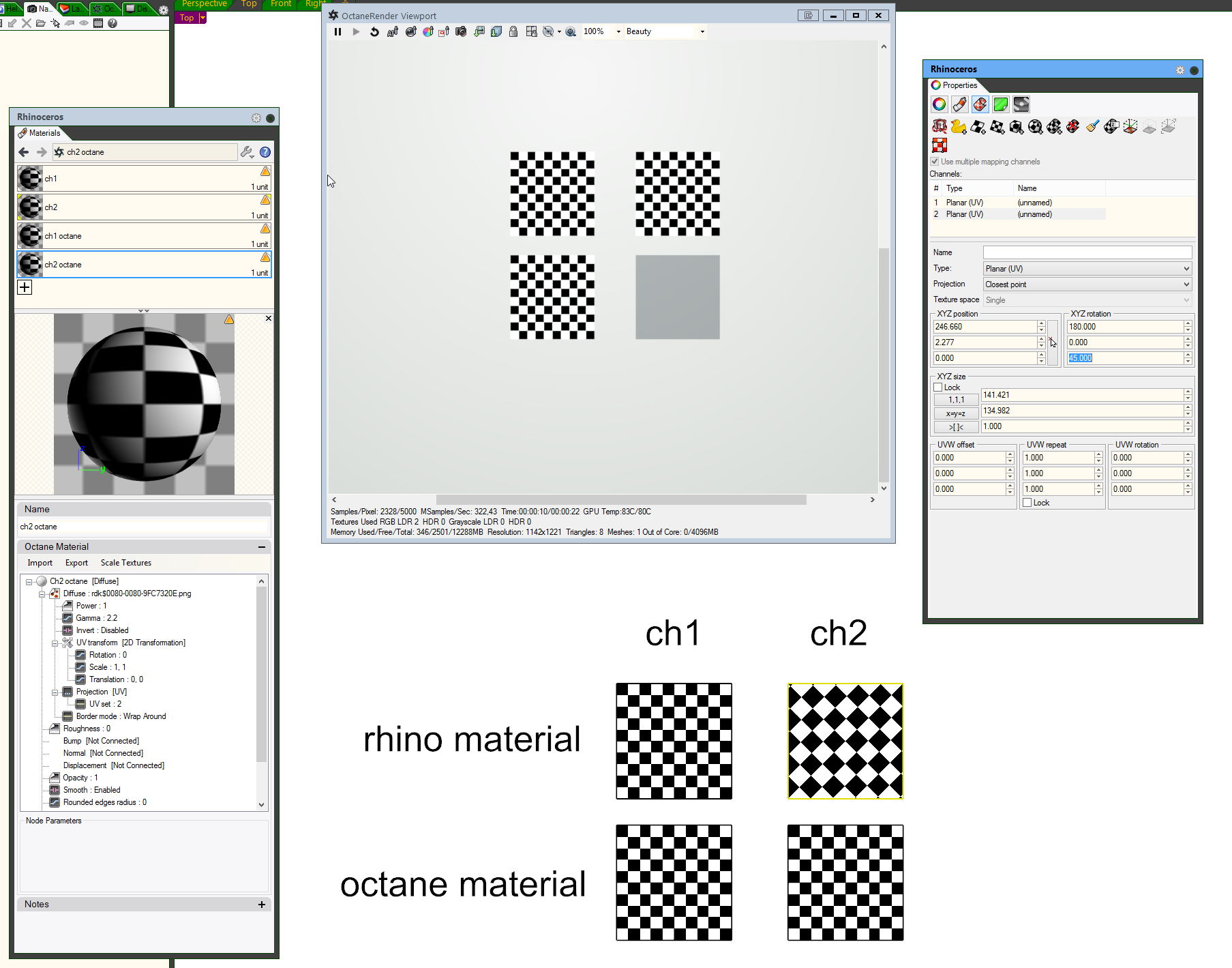

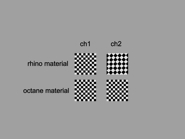

file attatched!
mapping channel setup of all the planes is identical, only materials differ
below is a rhino render
right column uses channel 2 for displaying the diffuse map
left column uses channel 1 to display the diffuse map
here you see it all in one picture,
so the following things can be observed:
A- if a rhino material uses channel 2 and is rendered via octane it renders like using channel 1
B- if a octane material uses channel 2 and is rendered via octane it renders the average colour of the map
C- Octane open GL preview does not seem to take account of the UV set setting, and displays the map like channel 1
other render engine directly from rhino: (of course the octane material won't be picked up correctly, but the top row with rhino materials works as expected)

Thanks for taking the time to put all this together. I understand what you are trying to do - and see that Octane is only reading the UV set 1 (ie. Mapping Channel 1). I'm not sure that the RhinoCommon API allows for getting Mapping Channels 2 onwards, but have put the question to the McNeel team. https://discourse.mcneel.com/t/accessin ... mmon/42670. I will respond here when I know more.
Paul
