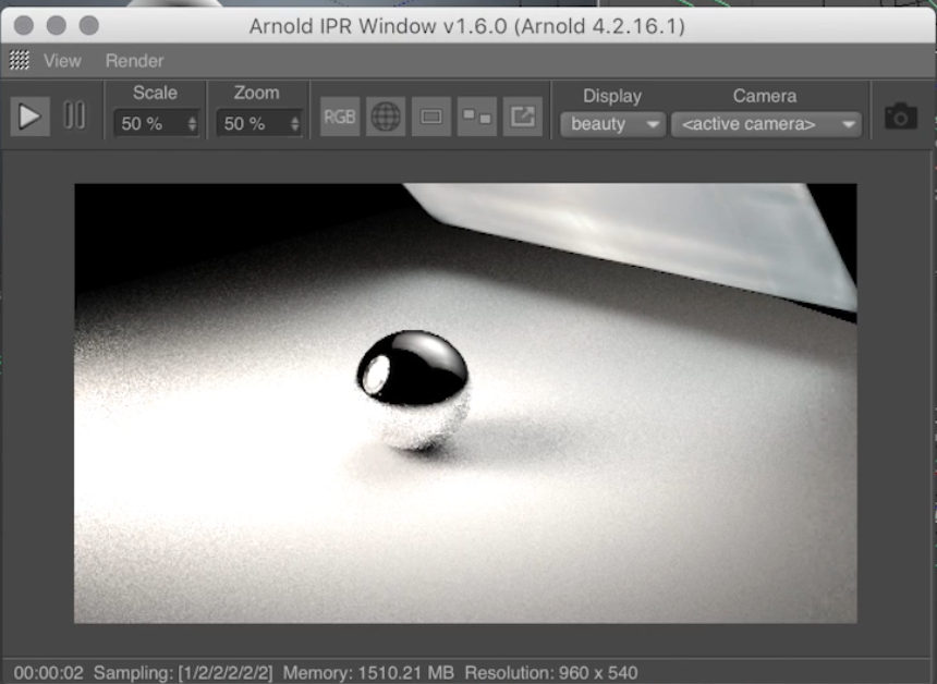

I've downloaded the samples HDR textures and been trying to setup Octane Area Lights to look similar to what he does in the demo video > https://www.pingo.nu/hdr-studio-lights-demo > he uses Arnold and puts the texture on a plane, but i'm sure this can be achieved with Octane.
Here you can see the texture of the light and he is able to move it around and the texture remains mapped correctly

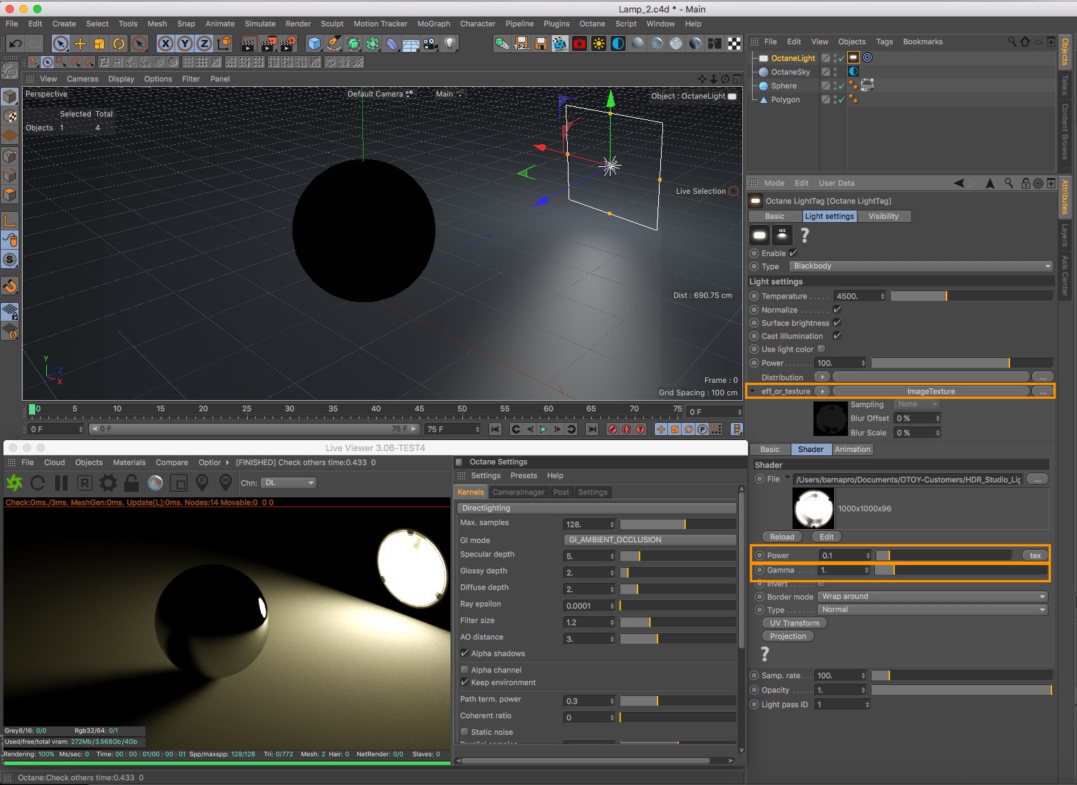

in order to use this technique, you need to use the Texture/Efficiency node, not the distribution, that is designed for IES light.
Please have a look at the following screenshot:
you can set the Gamma of the HDR image at 1 and reduce the power to match the efficiency of the specific light source.
If you need to more Watts, you can set the opacity of the Area lighrt at 0, and add aplane in the same place witht the same material but with Cast illumination option unticked, to better controll the reflection and the illumination separately, just like he did with Arnold.

Thank you for the instructions Beppe, they worked perfectly! I appreciate it
