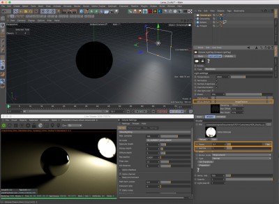

Hello everyone!
Rapahel Rau recently posted some new work where he mentions using HDR Studio lights from https://www.pingo.nu/vfxtools/
I am assuming he applied these HDRs to Octane Area Lights to light his scene, since he also mentions he used an extra HDRI for ambient lighting.

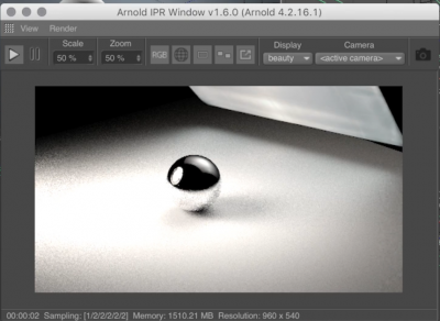

I've downloaded the samples HDR textures and been trying to setup Octane Area Lights to look similar to what he does in the demo video > https://www.pingo.nu/hdr-studio-lights-demo > he uses Arnold and puts the texture on a plane, but i'm sure this can be achieved with Octane.
I've got close with the IES setup, but I can't get the texture to map correctly + I have to reduce the power of the light a lot for the texture to show.
Any suggestions?

Hi jsuarez388,
in order to use this technique, you need to use the Texture/Efficiency node, not the distribution, that is designed for IES light.
Please have a look at the following screenshot: you can set the Gamma of the HDR image at 1 and reduce the power to match the efficiency of the specific light source.
If you need to more Watts, you can set the opacity of the Area lighrt at 0, and add aplane in the same place witht the same material but with Cast illumination option unticked, to better controll the reflection and the illumination separately, just like he did with Arnold.
Happy rendering,
ciao beppe
Happy rendering,
ciao beppe
