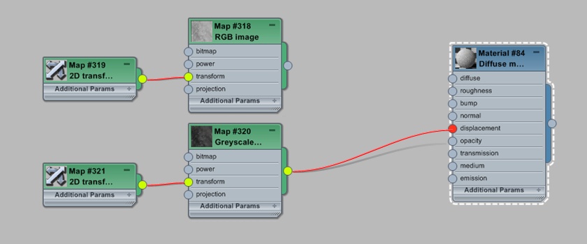

I want to use an rgb image to make displacement.
The material I use is a Diffuse.
So to connect my RGB image to the displacement slot I guess I need to use a Greyscale image node to convert RGB to grayscale...but that doesn't work.
Anyone knows what am I doing wrong ?
Octane 3.04.5 + 3DS Max 2014 plugin (GTX 980 Ti + GTX 780)

Hi Paride,
thks for the help Paride
But even if I converted my bitmap to a 16bit TIFF black and white file it still doesn't work.
Wether I use a "RGB image" or a "Greyscale image" node.
It can't be connected to the displacement slot of the diffuse material.

Hi Fabrice,
you have to use the displacement node before the image node.

Ok, It works now.
