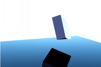

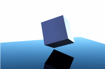

I guess I need to give a bit more info.
The animation is being handled within daz studio using the animation tab in the octane plugin.
The scene at its basic has an object that is set to invisible to camera and a plane with a specular transparent material on it. This allows you to see the invisible to camera object as it passes behind it.
A static render is fine but the animation option in the plugin appears to not use the camera visibility option.
Isotemod
Posts: 192
Joined: Wed Mar 16, 2011 5:58 am
So the above is a what happens and a manually animated what should happen
