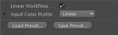

Settings in Cinema 4D
I read that this should be set to Linear or Disabled.

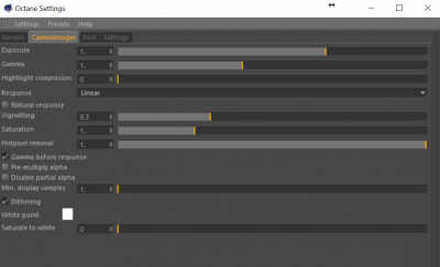

Octane Plugin Settings
I've set the Camera Imager Response to Linear

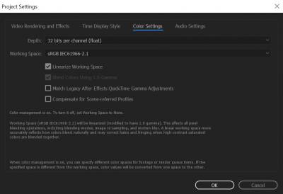

Once rendered, I go to After Effects and set my project working space to sRGB and click the Linearize Working Space checkbox as so:
AE 2017 Settings
AE 2017 Settings
My EXR sequences show no embedded color profile. It also doesn't make a difference if I manually set the footage to use Preserve RGB, sRGB, etc.
All that said, the images inside Cinema are generally darker than inside After Effects. It's not ridiculously far off, and I can tweak the color usually, but I'd much prefer to have a more accurate result from C4D to AE.

Try changing Gamma to 2.2 in Camera Imager (it's the proper gamma to use with Linear response in LV).
With a value of 1 you are viewing your render brighter in LV, so maybe your are setting your ilumination too dark.

Thanks so much, that totally did the trick. That makes LV and AE look nearly identical.

Also try setting vignetting to 0 in camera imager settings. It's 0.3 by default.

All great stuff Milan. Thanks for that. Also, thanks Yan...I noticed that as well.
