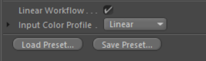

I read that this should be set to Linear or Disabled.
Octane Plugin Settings

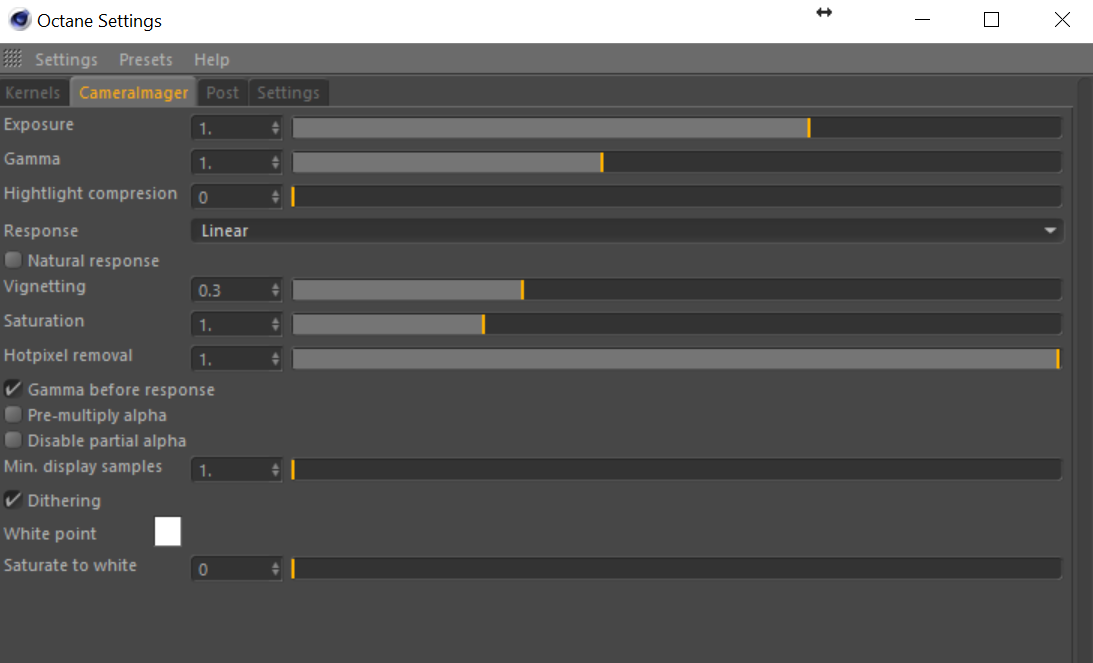

I've set the Camera Imager Response to Linear

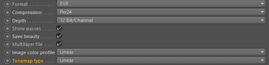

I'm saving openEXR files at 32 bit with Linear selected for the Image Color Profile and Tonemap Type set to Linear as well.

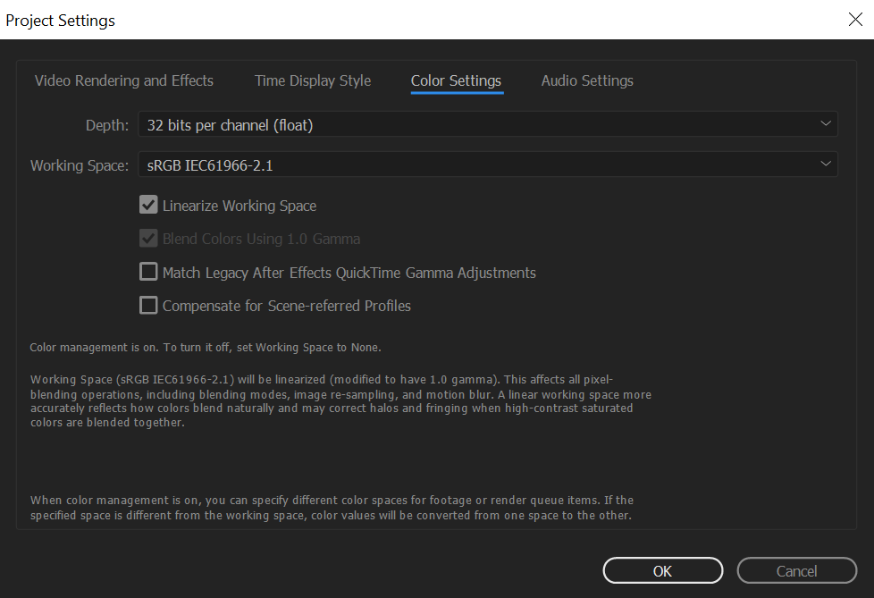

Once rendered, I go to After Effects and set my project working space to sRGB and click the Linearize Working Space checkbox as so:
AE 2017 Settings
AE 2017 Settings
My EXR sequences show no embedded color profile. It also doesn't make a difference if I manually set the footage to use Preserve RGB, sRGB, etc.

Try changing Gamma to 2.2 in Camera Imager (it's the proper gamma to use with Linear response in LV).
With a value of 1 you are viewing your render brighter in LV, so maybe your are setting your ilumination too dark.

Thanks so much, that totally did the trick. That makes LV and AE look nearly identical.

Also try setting vignetting to 0 in camera imager settings. It's 0.3 by default.

All great stuff Milan. Thanks for that. Also, thanks Yan...I noticed that as well.

Hi, u dont have to do anything to camera imager like linear and 2.2 gamma in order to get ur things straight. No matter what, when export linear/linear and EXR, u get the proper result aka linear and gamma 2.2. Even if u use luts in camera imager, even if u use highlight compression etc, u will always get a non LUT render with unclamped highlights.
What i do: I have converted the luts of octane for AE and i reapply em in post and get 1:1 with my live viewer, cause i dont wanna see a linear result as im working, i love octane for being able to see something more than this. Keep in mind that the only difference u will see between ur exports (even if u apply LUT in AE) is the vignette setting. Turn it off if u want from camera imager and do some tests u get an exact back to beauty comp.
