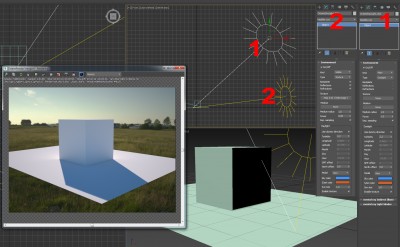

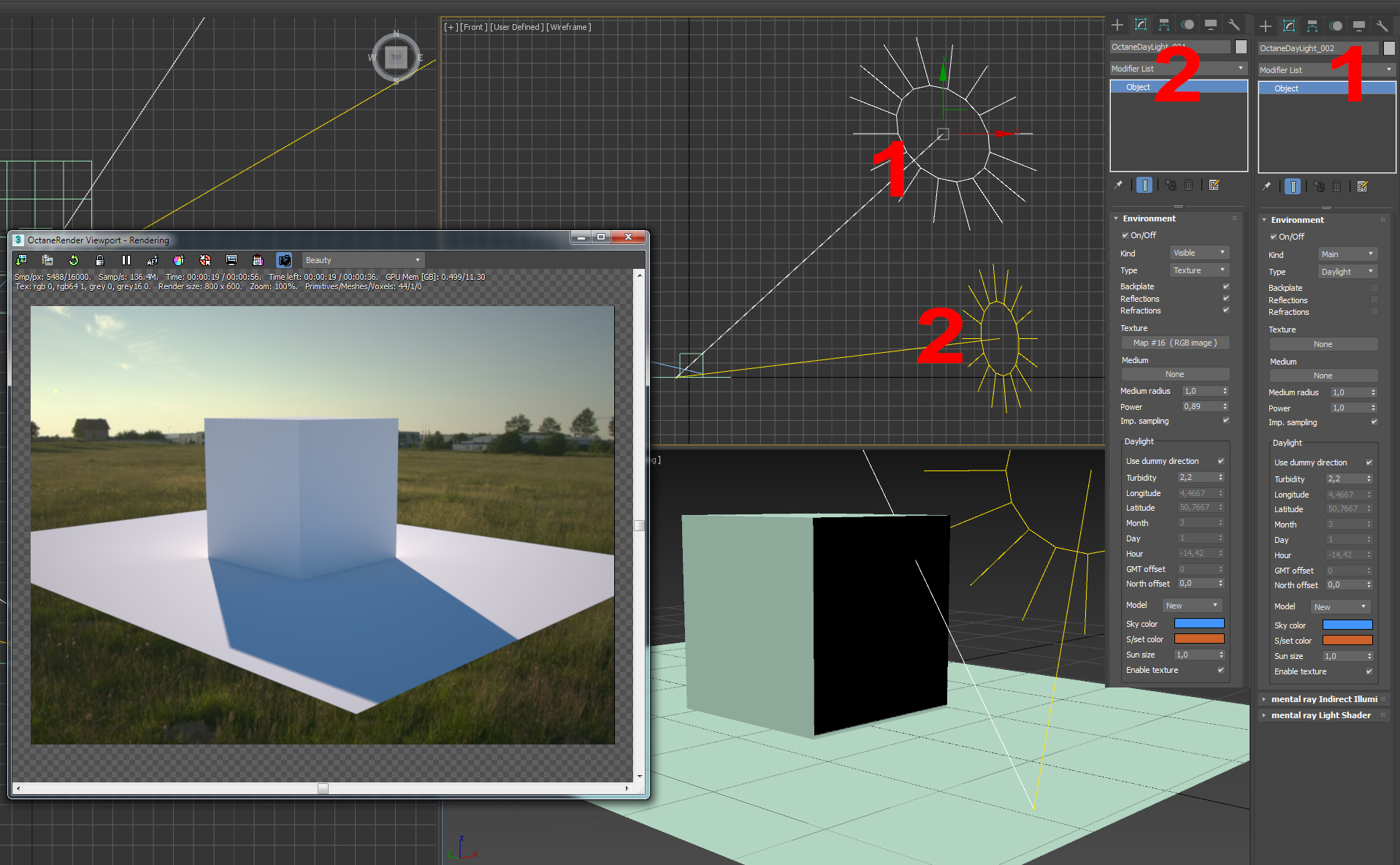

Hi mark0spasic,
attached a screenshot about sun+hdri workflow.

Thank you paride4331 so I need two suns to be able everything to work as it should. In standalone this is more intuitive than in max.
