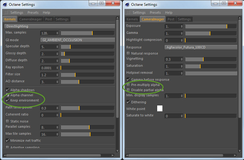

Have you ever checked and tested these marked parameters? And searched in manual and forum? At least tested the render outputs in AE or somethings else?

I'm not trying to render with an alpha channel. I'm trying to map live action green screen footage on a plane and key it out.
