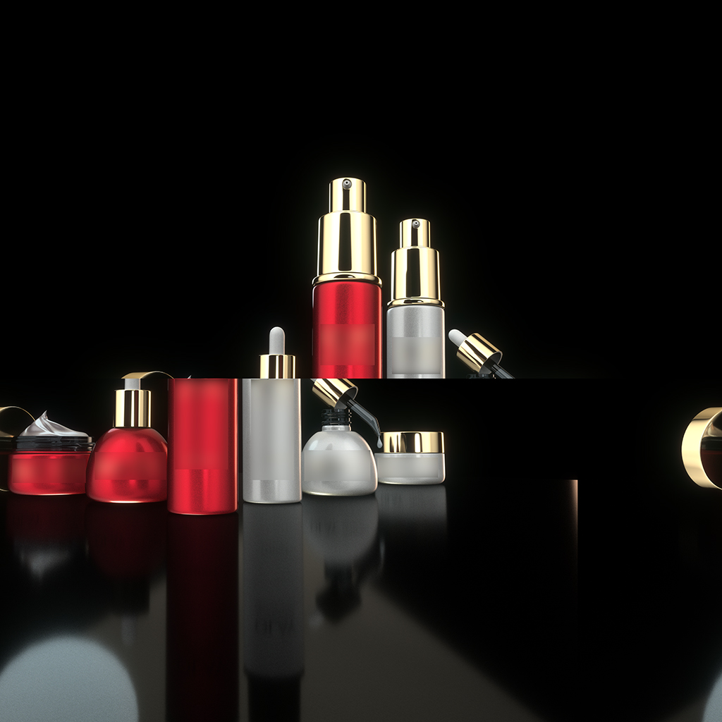

Hi there, I've been encountering successive crashes with Octane when I am trying to render an image of 16000x16000px in 350 dpi (requested by client).
The preview while rendering split the image into mosaic and finally (if no crash) the image is split in 2 as in attachment
result direct lighting 20 samples

The C4D scene is simple and local (hosted on computer). We 've tested in low poly and without any textures, still crahsing or weird results as in image below.
Any idea, similar experience or any known limitation I am not aware of to get the right image in the requested format/size/def?

and btw I tested to render by region, and same results, the image is split and displaced.

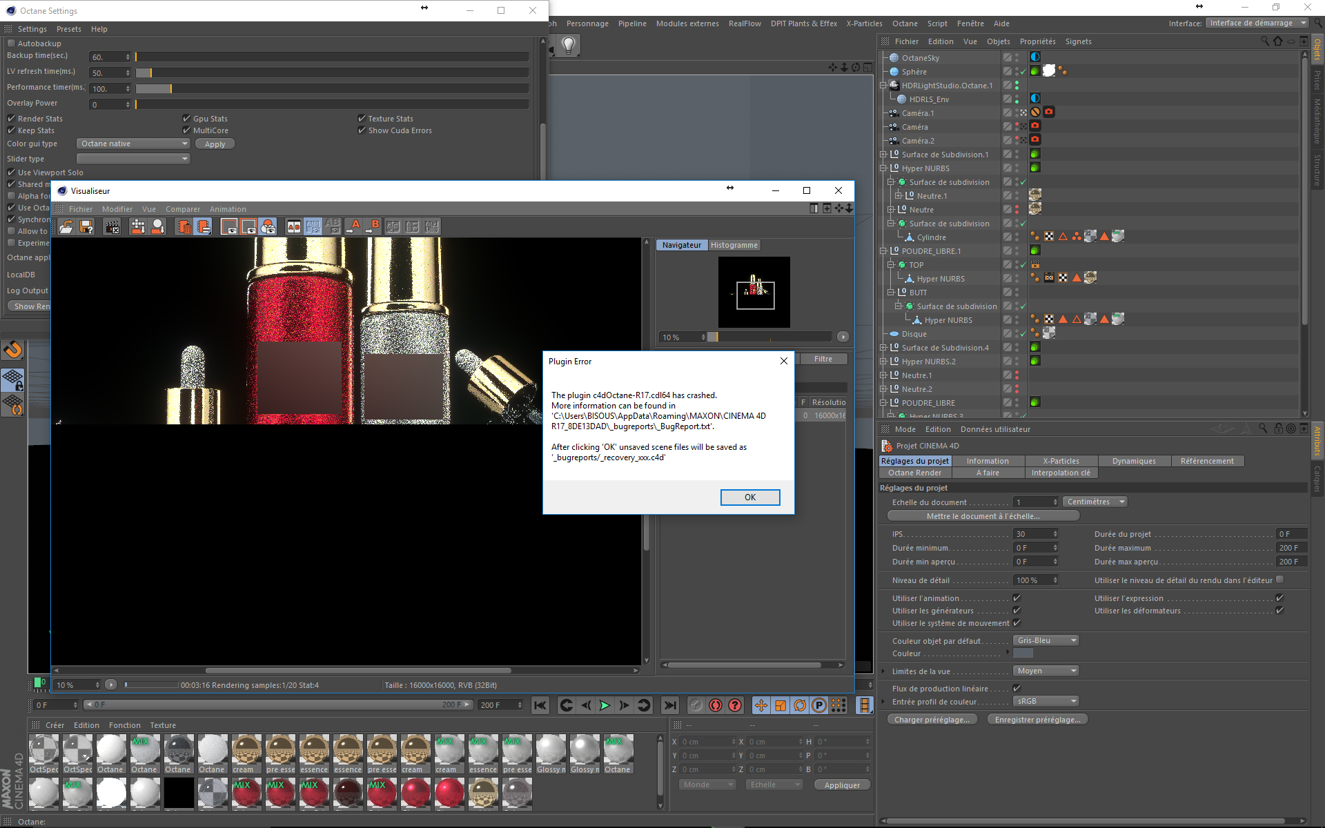

But same issue : split screen and crash of C4D, see
bug crash C4D text box
and the corresponding bug report
_BugReport.txt
bug report2
(412.34 KiB) Downloaded 246 times

I tested a new rendering, now I have errors cuda 702 ....
