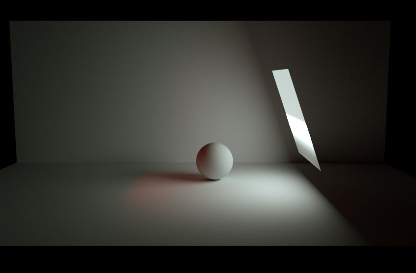

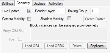

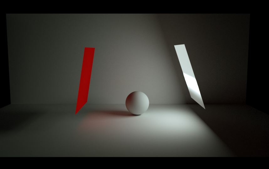

Hi
Check this out
This is normal
normal mode
normal mode
This is live geometry :
live geometry with settings
With this settings:
settings
settings
Does exactly what you wanted.
