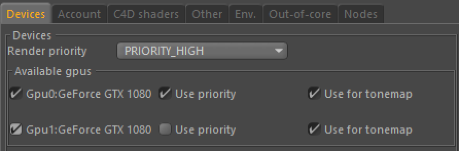

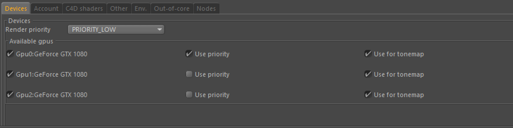

I have a 3x 1080 system, and I have two questions:
1.- While rendering to LV, I select 2 of the 3 GPUs and set to High Priority. Does this mean that Octane will use these two GPUs at 100% to render to LV and leave the other GPU alone for the system?
2.- When rendering to PV I know there's an option to "Use all GPUs", but what If I want to make Octane only use 2 out of the 3 GPUs to render to PV? just leave "use all GPUs" unchecked?
I think this is specially useful for people that have for example 2x Titans and one GTX970. I would like to use the two Titans for LV and PV and leave the GTX970 alone for other system tasks.

Posts: 10623
Hi jsuarez388,
1. no, Priority option is only for GPU connected to a monitor, so in your case you have to leave unticked.
2. just don't use the Use all GPUs option, in this way, only the GPUs active in the Devices tab will be used.
Happy rendering,
ciao beppe

Posts: 10623
Hi jsuarez388,
you have to use the Priority option for all the GPUs connected to a monitor, in this way a portion of the GPU is leaved for managin the monitor. I don't have the exact numbers, but, just to give you a better idea, let's say that, with Low priority you have a 20% of GPU for the system, while in Medium 10%, and finally in High only 5%.
Use for tonemap must to be desabled if the specific GPU is connected via low speed PCI x1 raisers.
ciao beppe
