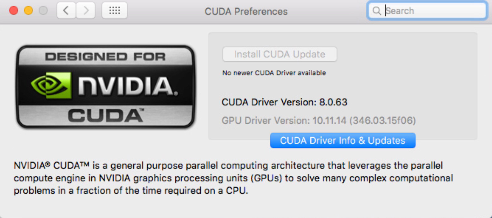

I want to try Octane on a Mac Pro (MacOS 10.11.6) with the test version 3.04.3.
When rendering Cuda error 719 appears. I guess it's a driver issue. Which version of the Nvidia driver is the correct one.
My card is a GTX 780 TI.
Thanks for any hint!

Hi Ron,
no problem here with 10.11.6
what version of CUDA drivers have you installed?
ciao beppe

Beppe, thanks for your reply.
I actually have the same driver versions like you have.
I am using the original AMD graphics card for display and the Nvidia card for rendering. Could this cause the problems?
Last test with a simple scene (cube and daylight) leaves the LV black and nothing else happens.

Hi Ron,
have you tried with Standalone?
Do you have the same behavior?
Try to roll back to an older version of CUDA drivers, the last one are not perfectly stable.
ciao beppe

Hi Ron,
please, try to remove the AMD card and try only with 780ti, note that probably you will see a black screen on boot until the desktop suddently appears.
ciao beppe

Looks like a faulted card. Tried the Nvidia card only but the screens remained black ...
Bad ...

I got another GTX 780TI and tried it solo - without the AMD card. The card is recognized by Octane etc. but now CUDA error 700 appears.
What can I do to get this working?
Hope someone can help!
