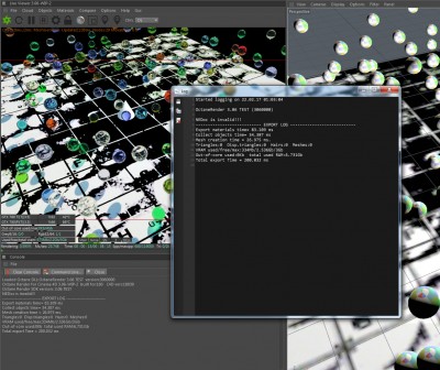

You can activate saving to log file. Extract octane_log_flags.txt to Cinema4D directory. It will write octane_log.txt.

Thanks I will copy that file in and see what the log captures.

Try to decrease 'render/editor' subdivison values.
Export materials time= 20801.13 ms
Collect objects time= 267.785 ms
Mesh creation time = 1865.635 ms.
Triangles:0 Disp.triangles:0 Hairs:0 Meshes:0
Total export Time = 23179.323 ms
movable:2 Nodes:757 camMb:0 objMb:0
Device:0 TotMem:8Gb rtData:0Kb film:0Kb geo:0Kb node:0Kb tex:0Kb unavailable:4.001Gb temperature:32
Device:1 TotMem:8Gb rtData:0Kb film:0Kb geo:0Kb node:0Kb tex:0Kb unavailable:3.96Gb temperature:31
Device:2 TotMem:8Gb rtData:0Kb film:0Kb geo:0Kb node:0Kb tex:0Kb unavailable:3.92Gb temperature:30
Device:3 TotMem:8Gb rtData:0Kb film:0Kb geo:0Kb node:0Kb tex:0Kb unavailable:3.92Gb temperature:33
Break rendering...
These first errors comes from C4D not Octane. Second part is octane. This is not what i want to see. Pls read my previous post again. We need octane_log.txt under C4D folder.
