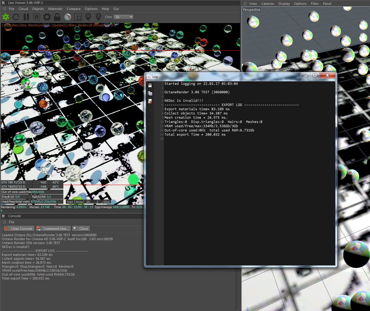

But where is the log stored on the HDD in windows? I can't find it. When you close/reopen C4D (on crash even) the log as accessed by LV menu "Show Octane Log" is cleared session to session?
Posts: 16066
Location: Türkiye
You can activate saving to log file. Extract octane_log_flags.txt to Cinema4D directory. It will write octane_log.txt.
octane_log_flags.zip
