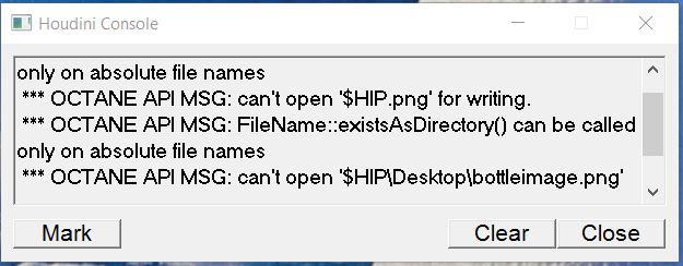

EDIT: Tried to right click the IPR window to save out a png and I get this error message. Can you explain what I may be doing wrong?

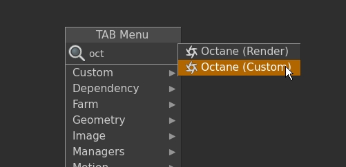

The problem with the ROPs is due to the ROP creation script. I'll check it if it can be fixed, but the workaround is to add the "Custom" Octane node. From the "Custom" tab you only should get one ROP.

VISUAL360 wrote:EDIT: Tried to right click the IPR window to save out a png and I get this error message. Can you explain what I may be doing wrong?
The problem is that that this function doesn't support relative paths using Houdini variables like $HIP. I'll fix this issue for the next build. Thanks for reporting this issue.
-Juanjo
This issue has been fixed for the next build.
