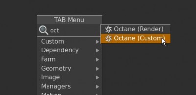

3. Whenever I go into ropnet1 and search for my octane_rop1, it doesn't show up until I drop another octane_rop2, then I end up deleting it. Why is that?

I'm not sure about your latest question. If you add an Octane ROP inside a ropnet using the shelf icon, or from the "Custom" menu tab, I can see the ROP inside the ropnet without problems. Can you elaborate this issue?

Thanks for your answers. As for the last one, when i double click the ropnet1 to go into it, I can't see the Octane ROP1. I only see it when I add another Octane Render node (Octane ROP2).
See vid.

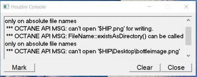

EDIT: Tried to right click the IPR window to save out a png and I get this error message. Can you explain what I may be doing wrong?

The problem is that that this function doesn't support relative paths using Houdini variables like $HIP. I'll fix this issue for the next build. Thanks for reporting this issue.VISUAL360 wrote:EDIT: Tried to right click the IPR window to save out a png and I get this error message. Can you explain what I may be doing wrong?
-Juanjo

This issue has been fixed for the next build.juanjgon wrote:The problem is that that this function doesn't support relative paths using Houdini variables like $HIP. I'll fix this issue for the next build. Thanks for reporting this issue.VISUAL360 wrote:EDIT: Tried to right click the IPR window to save out a png and I get this error message. Can you explain what I may be doing wrong?
