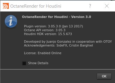

This was indeed a bug, but it has been fixed several builds ago. Are you working with the latest version 3.05.3.0?

Yes. I have the latest version. See image and vid showing what happens.

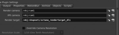

I can reproduce the IPR camera issue. I'll investigate to see why it happens. Thanks for the scene.

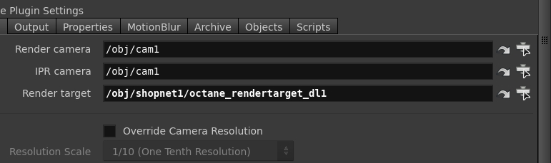

The problem is related to have in the ROP node the render target referenced to the vopnet inside the HDA. If you set the HDA path directly all works fine. Anyway I am going to see if this problem can be fixed.
