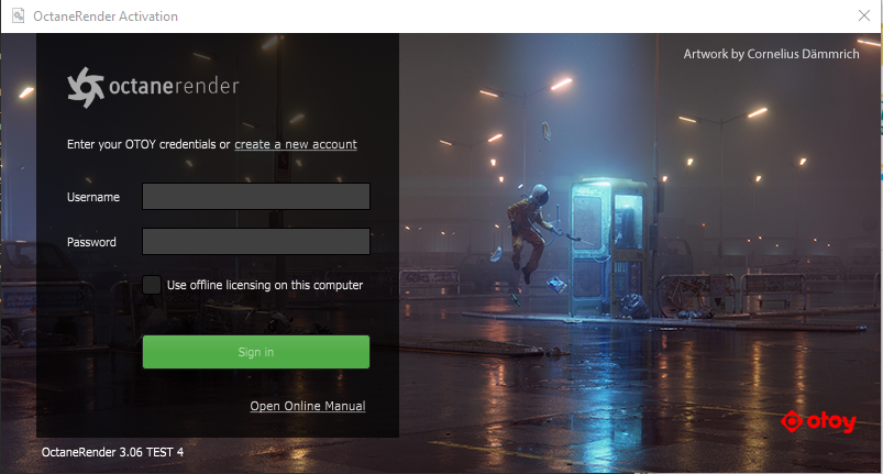

Hi psultan :)
The license error message is already there.
If there is an error with license activation, the Octane Render login dialog should pop up to login ;)

BK wrote:
If everything is setup correctly then Octane should bring up the Sign-in dialog, if it does not find any valid license.
That is what currently happens, however that is not a desired process when artists submit to a renderfarm and do not have access to input the account information. All other renderers will throw a "not licensed" error so the render manager knows to terminate the process and allow an alternate render on that machine. In order to solve this problem all you need to do is print out a warning to stdout/stderr that says "not licensed" before poping up the login window.

psultan wrote:
Hi Psultan,
Thanks again for the suggestion.
It seems our plugin has no control over the licensing system yet.
So we are checking with our core team if they could help us to resolve this issue.
