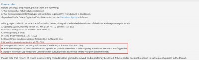

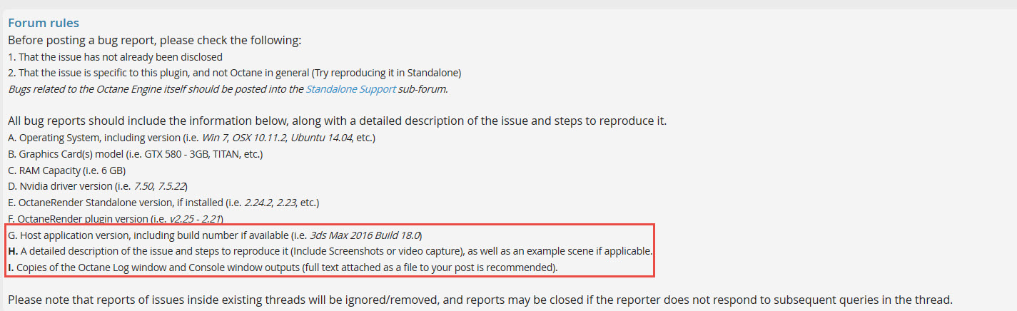

Persistant error while rendering
C. RAM Capacity (i.e. 6 GB)
Thank you! But i need to see scenes or more info about these. This kinda error is generally not about plugin side. Happens in the renderer. Maybe somethings are not fitting to vram or some hidden bug, etc...
