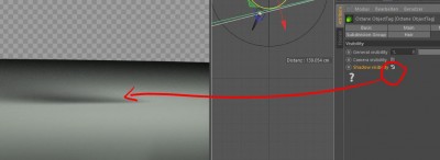

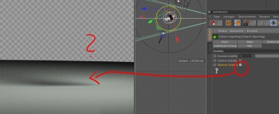

I have a plane with a blackbody emission material as a lightsource.
And a octane object tag assigned to the plane.
I always get a shadow from that plane casted on the ground
even if I turn off "Shadow visibility" (Camera visibility works as it should)
Latest Version 3.05.1
Any idear?
thanks
Mike

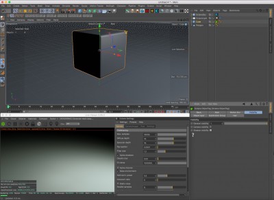

Hi Beppe,
its not the shadow from another object, its the shadow from the plane itself
which has the emission material applied.
regards
Mike

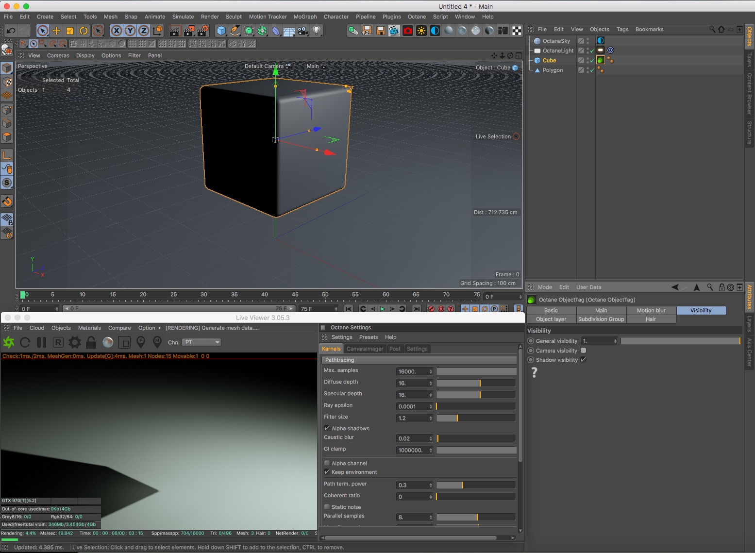

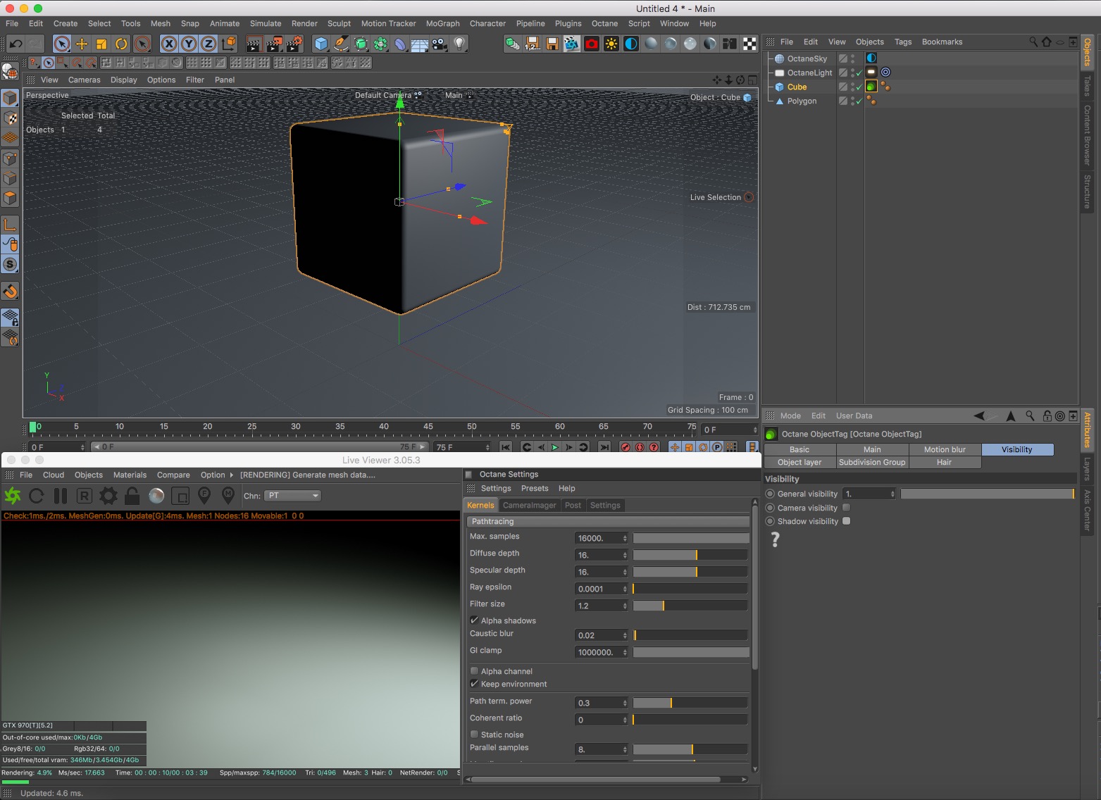

Posts: 16068
Location: Türkiye
Putting a scene would be great to show expectations and what that is not working. I can't see anything wrong here with shadow visibility. But as i can see there's a problem with general visibility. Plugin ignores that objects when "general_visibility=0". It's about some optimisation for generating less meshes for case but this is not fine for emissive geometries.
