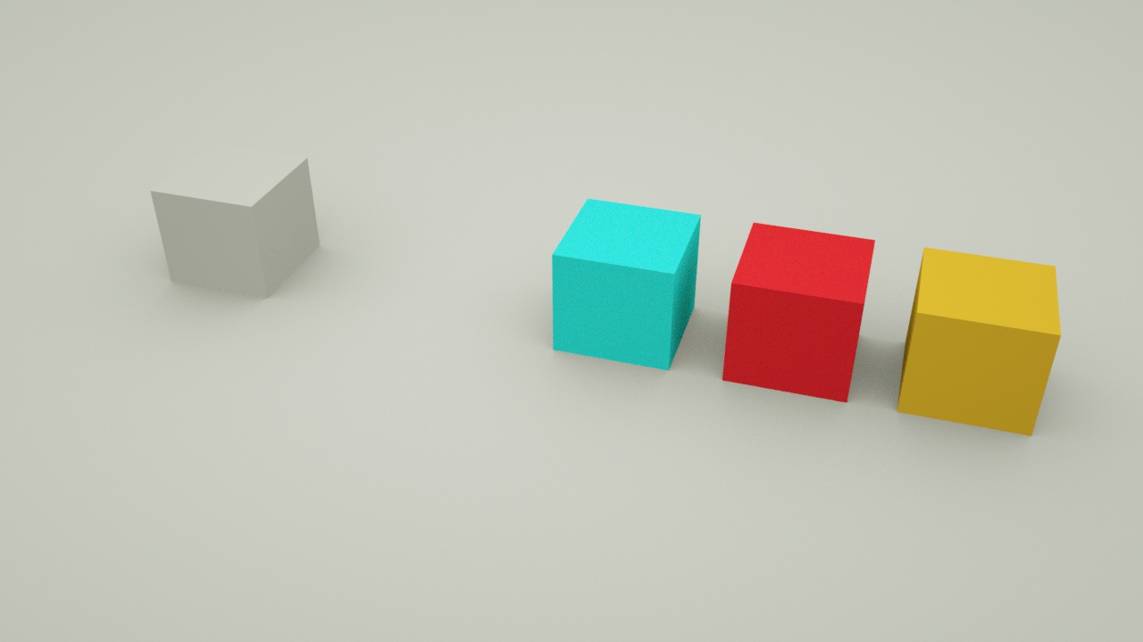

We have very often car-scenes with different cars and different colours. Is it possible to pick a special material to the renderinstance?
Thanks for your help.
Renderinstances with different materials

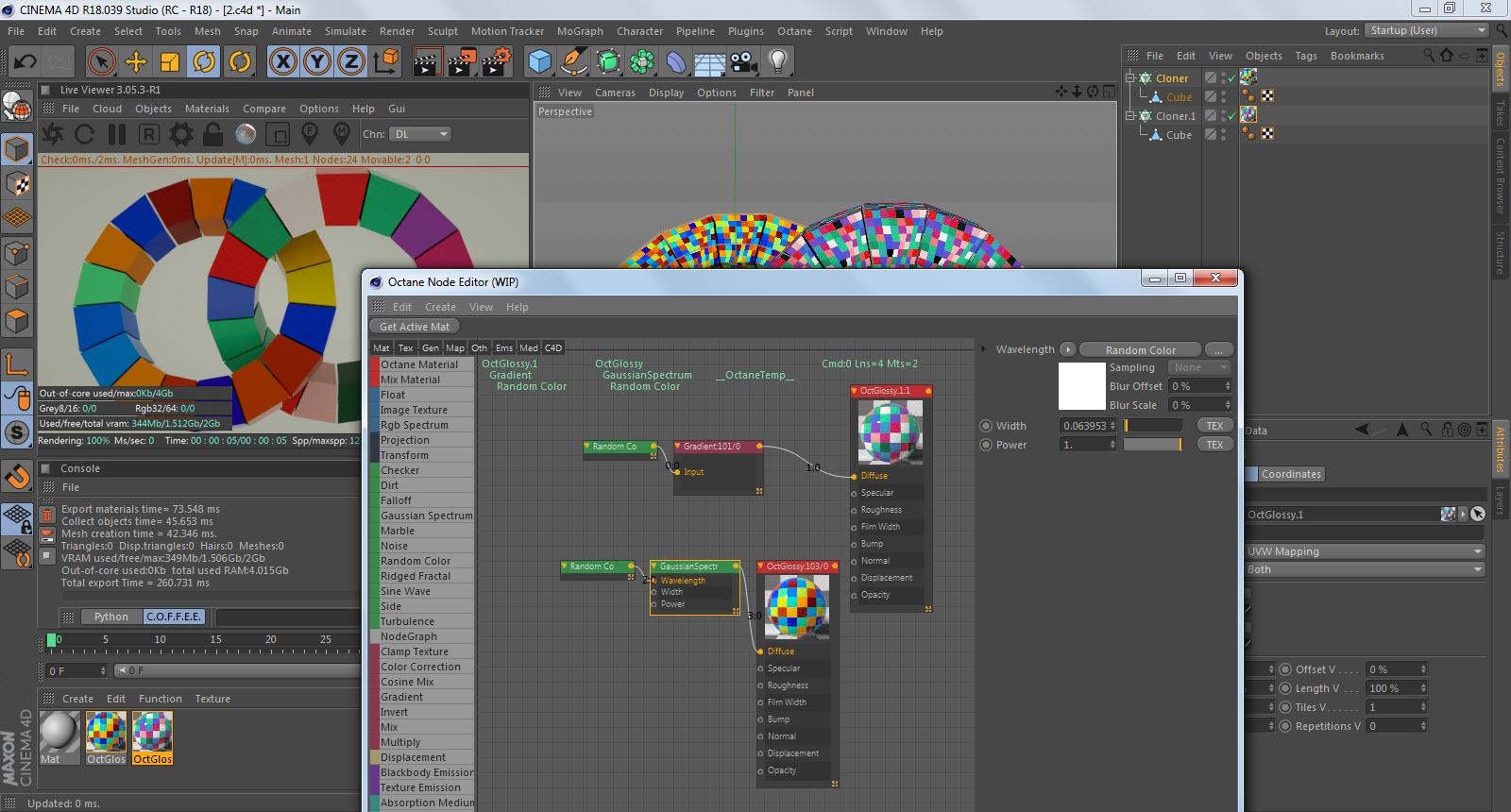

No as you thought. But you can use RandomColor texture. It will generate 0-1 values for render instances. Connect it to a octane gradient and give colors. Or check image for two different setups.
I cannot be used to change time on image sequences. But it should be working with octane gradients. Add some images under gradient and randomtex to input. I had idea for adding a button in gradient that will create multi images.TonyBoy wrote:Ahmet, another user was asking about randomizing image sequences on instances, Would the RandomColor texture be able to do this?
