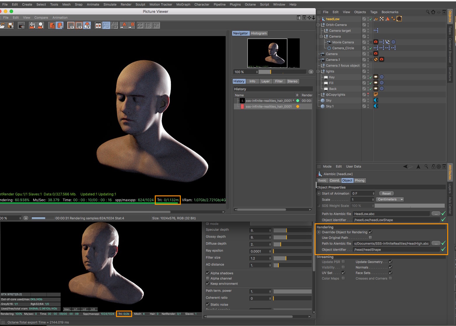

Posts: 10482
Hi ospinto,
as a workaround, have you tried with the alembic workflow?
in theory, the concept is similar:
[vimeo]http://www.vimeo.com/150553708[/vimeo]
https://vimeo.com/150553708
ciao beppe
