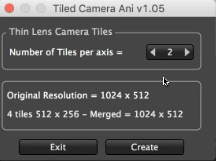

Thin Lens Camera,
The script creates an animator for the shift parameter, and changes some parameters like fov and resolution of a Thin lens Camera node. The user define the number of tiles per axis (from 2 to 89) and the script creates the animation. Vignetting and Post processing will be disabled, if present.
The new version takes into consideration if the original camera has already the Shif parameter different from 0.

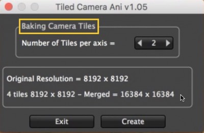

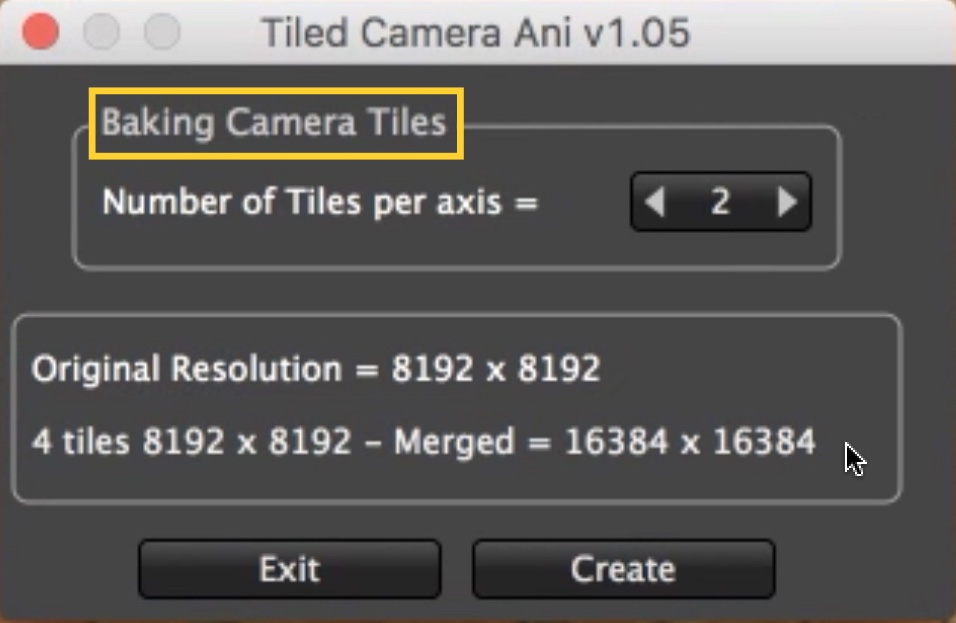

Backing Camera
Instead of splitting the frame buffer in tiles, the script changes the UV region Size parameter, and creates an animator of the UV Region Minimum parameter. In this way it is possible to multiply the frame buffer to obtain a high resolution version of the backed texture.

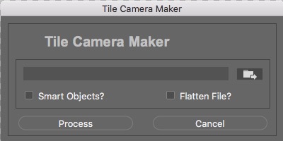

To assemble all the tiles in Photoshop, I use this modified old java script founded on the Adobe forum:
The attachment mergeTiledImages3.js.zip is no longer available
(2.28 KiB) Downloaded 1347 times
Create an empty document with the final resolution, run the script, locate the folder with the rendered frames and click on Process. Unfortunately it doesn't work with Cube Map VR frames.

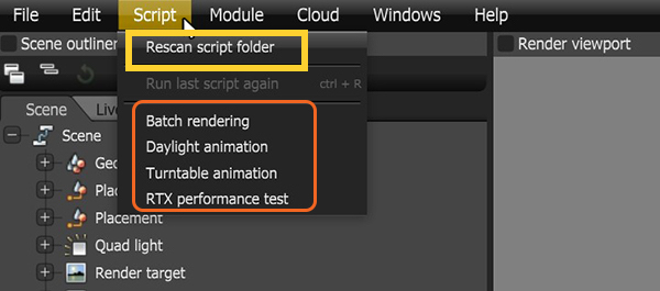

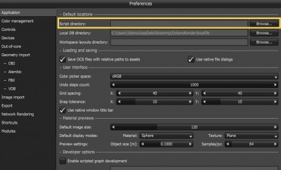

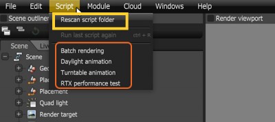

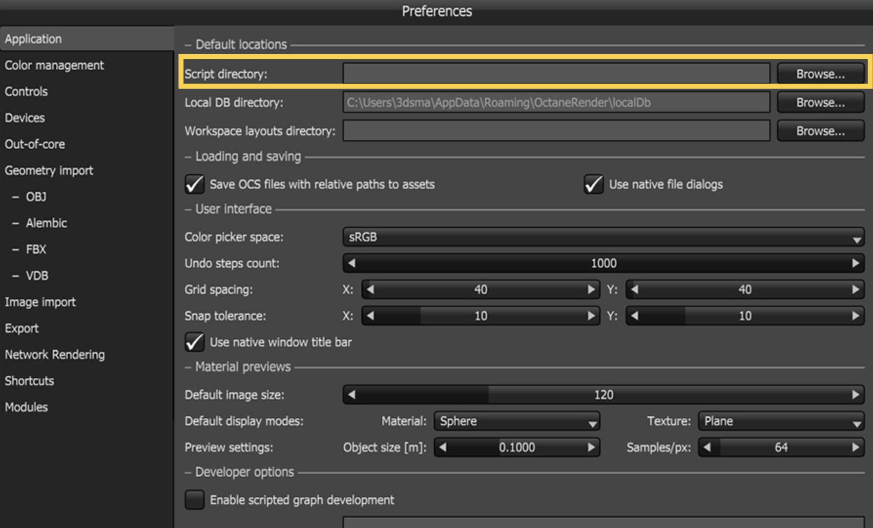

Posts: 10628
you can go to Standalone menu Windows/Create Scripting window, and load and run the script in it.
Alternatively, go to Standalone Preferences, and define a Script folder path:
Then copy in it the desired scripts, and restart Standalone, or use the Rescan Script folder option in Script menu:
ciao Beppe
