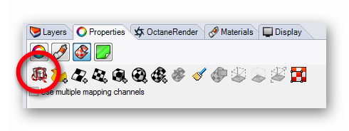

Worth giving the Rhino texture unwrap tools a go.
