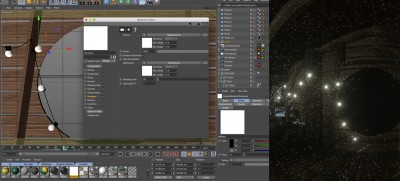

I am outputting an animation of a tree house, where a load of objects in it go Zero G, the light drops out and a light flies around it. There are some lightbulbs that I have on wires inside the treehouse that flash on and off (few frames per flash as it seems to be killing my render times), they use an emissive texture and it looks awful, I have read they are difficult to nail so my questions are the following:
1. For a video/animation, is there any other way that's more effective to light a bulb and have it react with the environment around it?
2. If it's emissive, can anyone give me an 'optimum' setting for it?

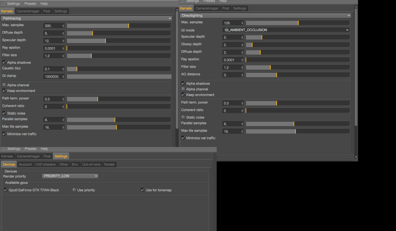

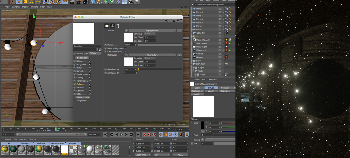

I am attaching some images that will hopefully shed some light... see what I did there, on the issue. If I need to upload any other images/settings etc please let me know. Have added my emissive texture settings, the right hand side is the render, it's like the light has only bounced one... not sure what to do to change that, is it samples? If so will that make my frames take forever to render.

with "looking awful", do you mean the white spots? search for "fireflies" in the forum

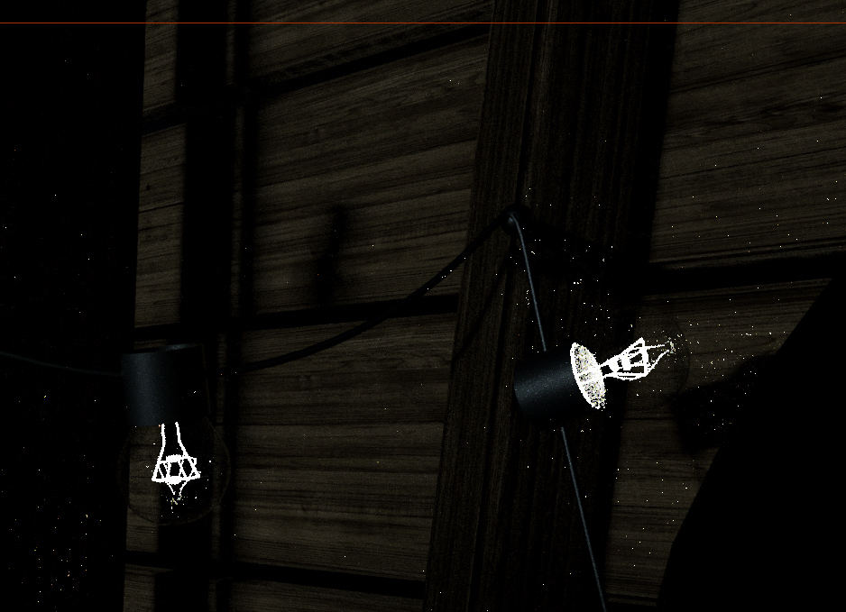

So I could see what was going on, I removed the post effects, then also turned the hot pixel removal to almost '0' ... this killed my fireflies, which is great but I think I see what the issues is.
My emissive texture on the bulb elements, is emitting light, but it's not landing on the wood surfaces or anything? Find attached an image, sure it's a silly mistake on my part, but i'm not sure what though?
It's almost as if the light is there but it's not going any further, it's like a particle emission and i've got the life span really low or something?
Thanks again for the speedy responses I really appreciate it.

my default approximate settings for these kinda scenarios
Kernel: PT
Diffuse ans specular depth: low as possible
Caustic blur: 1 or near
G_Clamp: 1-10
Coherent ratio: Around 0.3
Try to understand all parameters

Here's my image, so when I take off the glass 'bulb' object so it has no glass around the element, it starts to illuminate my scene. What does that mean I have done wrong with my object, do I need to tick some kind of 'pass through' to allow the light to pass through the object and glass material?

A detailed look at the glass material would be useful. Like a screenshot.
Posts: 10563
Hi JoeHunter91,
probably you have not ticked the "Fake shadow" option in the glass material.
Anyway your light setup is not efficient, please look at this other discussion about noise and emission:
