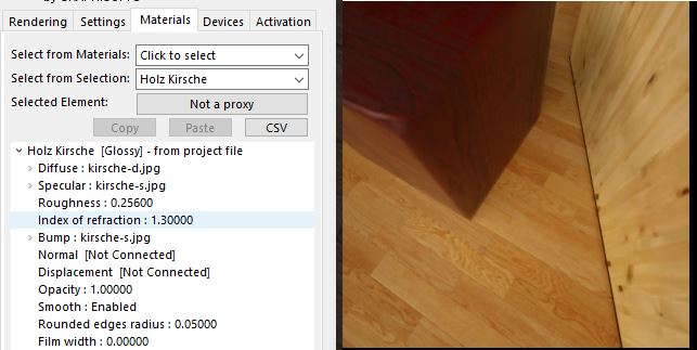

our office works with an own ArchiCAD template, and I have prepared all of the materials in Octane.
We should reorganize our server, and we had to move the textures as well (it was not my decision...). Anyway, I have to check sometimes all of the loaded textures, I would like to avoid invalid paths (old servers, user folders, etc.).
Is there any possibility to get a list from any loaded materials, that contains the path of the texture?
It would be interessant about used proxies as well...
Thank You
David

Thank Paul. I have tested the latest plugin, and the result doesn't show the list of the files with path.
Do I something wrong?
Hi David - are you certain there are images in your materials? Or if the png/jpg files are missing, they will not be reported as missing either (since the image filename will be blank in the Image node).

Not missing, not a proxy... :( How can I serve you more info about this issue?
