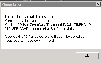

I updated my C4D to R17.55
Update C4D octane plugin to Octane 3.05.3 as well as installed the same version for Standalone.
However, after starting up C4D, I went to the Render Setting to Octane and checked Enabled Network Rendering Box and select Network Preference, Octane crashes with this image.
How do I go about fixing this?

did you follow the instructions in the readme.txt file to correctly install c4dOctane?
ciao beppe

Yes I did. It crashes and sometimes it freezes. Had to end it with task manager

It is running R13 ve4sion of plugin. Please.read readme.txt
Thanks for assisting. I got it working now.
What I did after crash was I start up C4D again,
Created a sphere and open the live viewer and it prompt me to sign in. Apparently my license was full so I had to unlock one of my PC license and sign in again and it didn't crash at all when I open network preference in render settings.
Thanks for the help guys!

Nice! Be sure that activation/deactivation is working correct on start/exit of C4D. You can check from licenses page.
