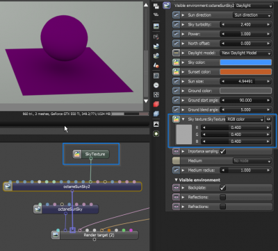

When using a Daylight node as visible environment backplate,
the displayed sky has no color, just full grey and a sun.
Tested the same setup in standalone and it works as expected, sky don't loose its colors.

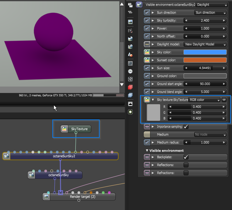

Exporting my bug sample scene to ORBX I found what's happening with this visible environment bug.
There is a mistake when the visible
even so I don't have anything plugged in the
sun-sky node is translated to Octane, a grey RGB color node is added to the sky texture attribute,even so I don't have anything plugged in the
sky texture attribute :
