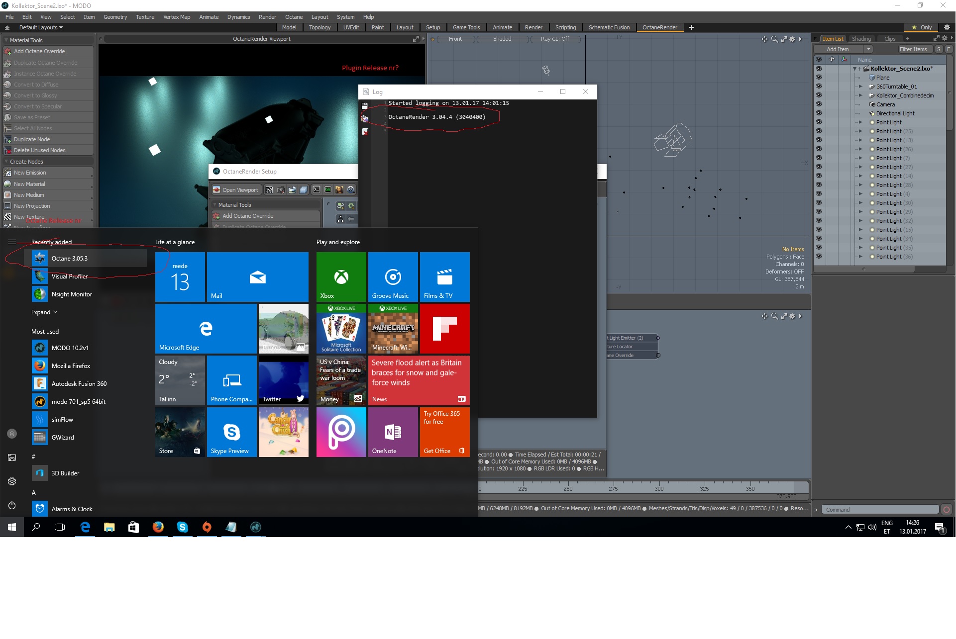

The number under Modo-Octane Log is not plugin release nr?
face_off
Posts: 15761
Location: Adelaide, Australia
If you stop the render, the version number is displayed in the viewport render statistics. It's also displayed in System->Kit Toggle Enable, and it's also on the filename of the plugin installer. Regardless, you should have the latest TEST or STABLE version installed - detailed at the top of viewtopic.php?f=34&t=55078.
