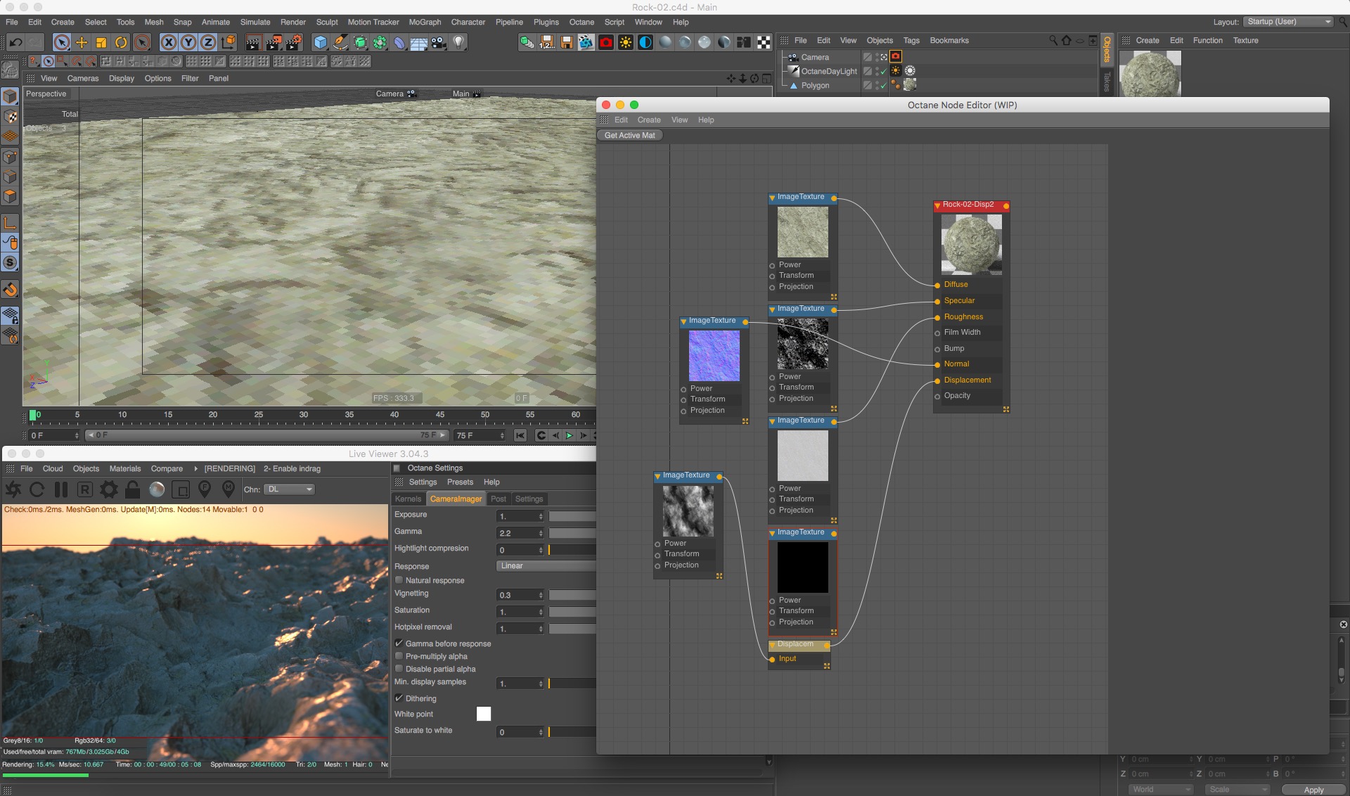

try with this ROCK-02 example:
Rock-02.c4d.zip
(123.31 KiB) Downloaded 410 times

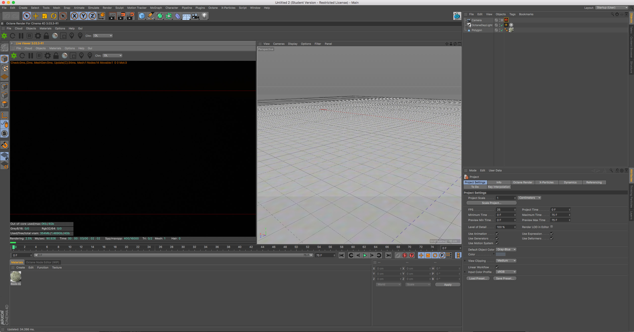

Hi bepeg4d i'm not sure but i can't get the file you sent to work. Tried opening and did a preview in Octane and just got a black screen so still not having any luck at all.

probably because I have shared only the c4d file without the textures. Please copy the file in the proper place or reconnect the textures with the Octane Texture Manager.
