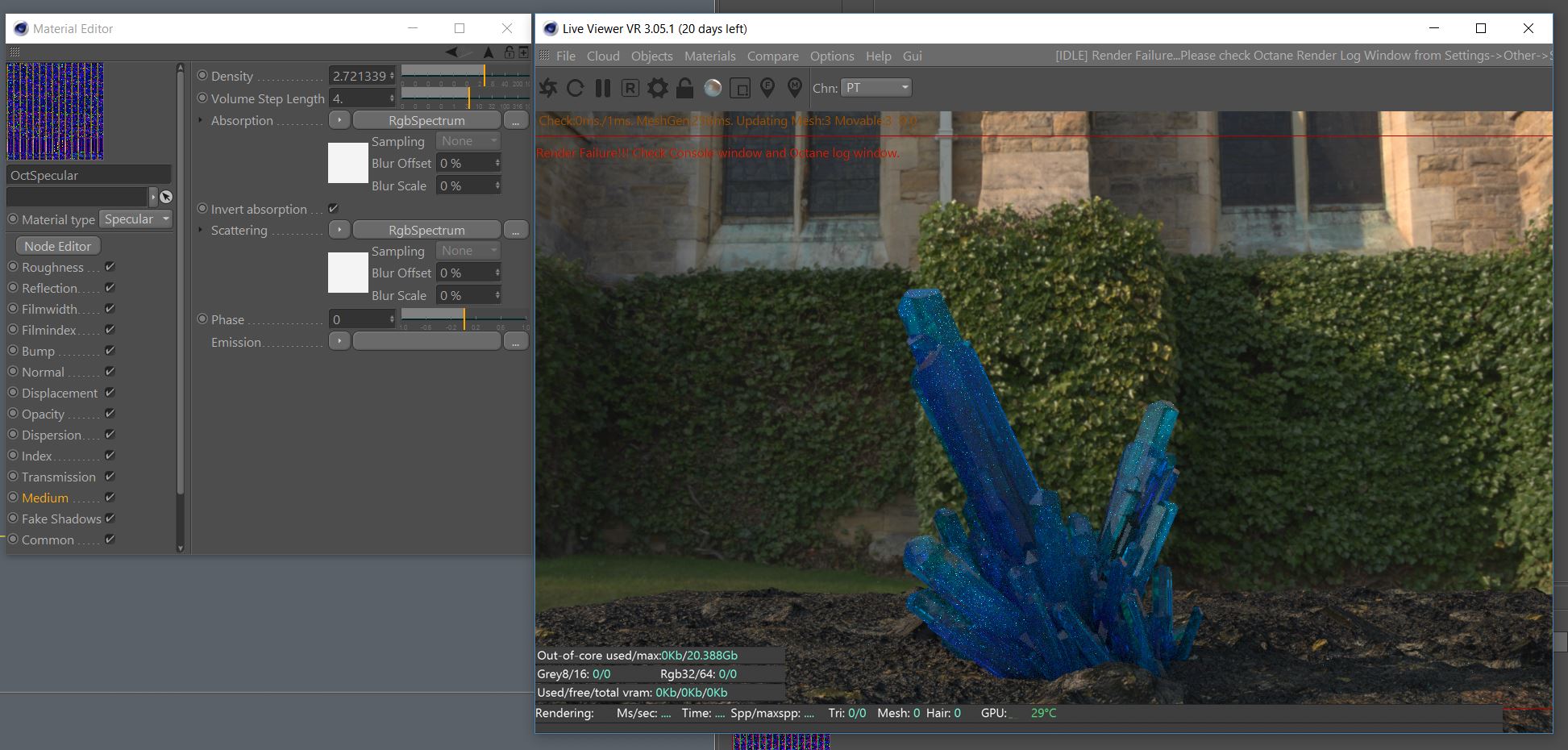

I'm in no better place since last time I posted and there's many threads regarding this same issue or similar with pascal cards. If I'm working with live viewer I get this error after abit, if I render to picture viewer it freezes part way in. It's unusable.
-> failed to deallocate device memory
CUDA error 700 on device 0: an illegal memory access was encountered
- I've rolled back drivers
- reinstalled different versions of plugin and standalone
- tried in Cinema 4D r17 and r18
Always come into same issue.
I've also tried to reproduce the problem in standalone, couldn't.
Grabbed Octane for 3Ds max demo also, spent hours trying to reproduce but couldn't. Seems that they run perfectly on my machine with materials/high res textures and complex scene, problem seems to only be with C4D plugin..
I also sent my machine back to the builders who stress tested each component and it flew through all the tests with no hiccups.

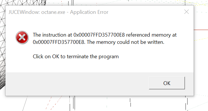

I tried export to animated orbx from Cinema to standalone but got this error
It still opened in standalone however, just can't for the life of me work out how to render the animation.
It seems that every error I get relates to memory in some way or another.
