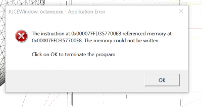

I tried export to animated orbx from Cinema to standalone but got this error
It still opened in standalone however, just can't for the life of me work out how to render the animation.
It seems that every error I get relates to memory in some way or another.
