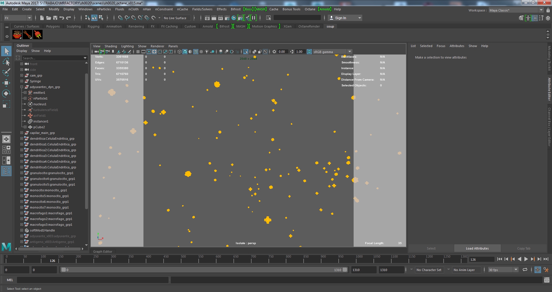

I have this partcle system, I used particle instancer to substitute particles for several objects.
Is there any way to render this in Octane?

I tested with a simple scene with particle instancer and works fine.
I had to look into it more deeeply.

mrfactory wrote:I tested with a simple scene with particle instancer and works fine.
Hi Mrfactory,
Great !!! Thanks for letting us know :)
Please make sure the instanced objects are all polys.
