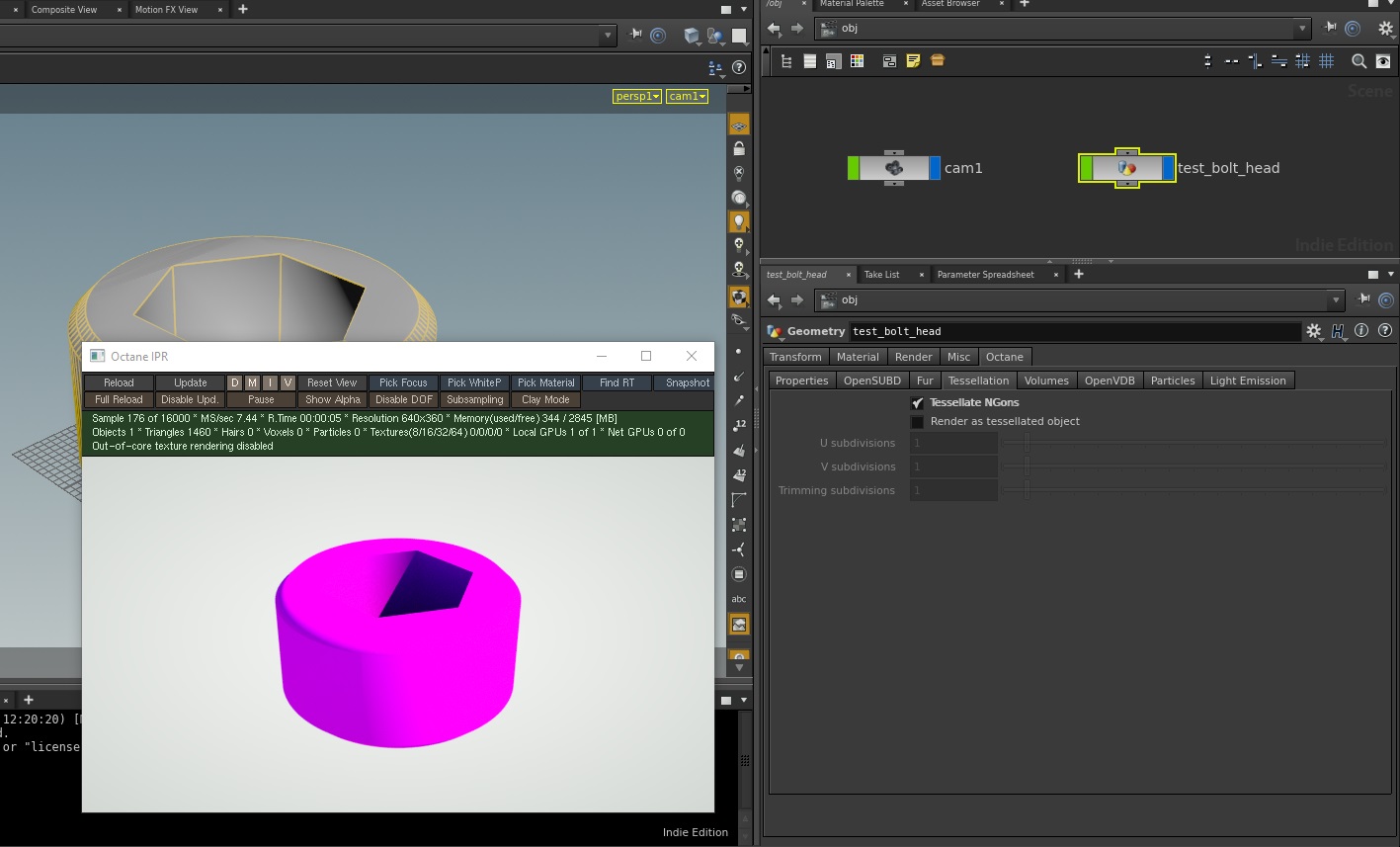

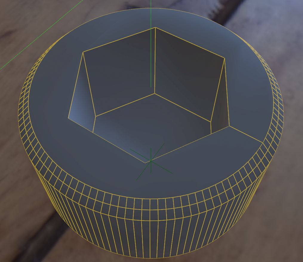

Another odd problem I'm running into in Octane for Houdini. I have a bolt head I've modeled in Houdini using the Cookie sop to subtract a hexagonal shape from a cylinder:
It renders as expect in Mantra, but Octane oddly seems to not want to render the hexagonal cutout:
Any idea what might be up with this?

The problem is that this polygon with a hole is not directly compatible with Octane, that only can work with simple convex polygons. You need to add to the object the Octane OBJ spare parameters and enable the "Tessellate NGons" option in the "Tessellation" tab to render this kind of objects.
