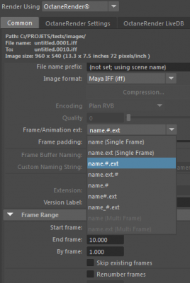

calus
Posts: 1308
Location: Paris

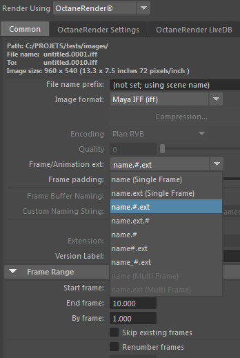

itsallgoode9 wrote: Yep, I had the same problem. IPR start = Maya freeze. Maya 2017 also
Finally I could reproduce IPR freezing also with Maya 2016,
I noticed the problem occur only if I have frame extension set to single frame.
But as soon as this is set for animation rendering, the problem disappear:
So maybe this is the same for Maya 2015 and 2017,
so if you want to use this release before it's fixed, just set render settings to animation instead of "single frame".
Pascal ANDRE
Renart
Posts: 70
Joined: Mon Jul 04, 2016 8:21 pm
Thank you Calus!
It solves the freeze problem for me on Maya 2017 :)
