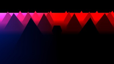

Octane produces an image with roughly blue to orange colors. As I understand it, it produce positive and negative values.
It doesn't work out of the box with RSMB pro vector.
Anybody with a workflow to make it work? What am I doing wrong?

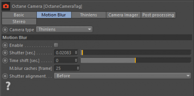

Activate the motion blur in the camera tag.
Set my shutter speed.
Activate my vector motion pass.
Result : my blue to orange image more or less intense depending on the speed of the camera move.

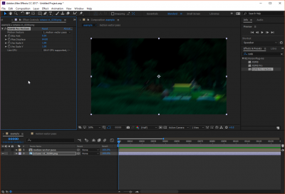

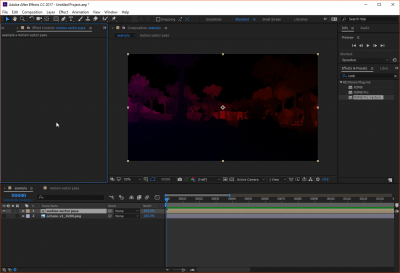

in after effect :
import my beauty pass
import my vector motion pass
add rsmb pro to my beauty pass
link my vector motion pass in rsmb
Result : everything is blurry, not how it suppose to be :(

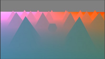

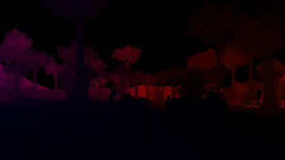

Top Left : result from octane, I exaggerated the blur so we can see the effect, it looks great - but let's say I need it to be control in post so I won't be able to use it.
Top Right : The result from Octane pass, which vary a little different from the LV (grey background color, probably a gamma/ situation - I'm not entirely sure)
from the Picture Viewer =
from the live viewer LV =
As you can see, it produces the full spectrum of colors. It is coded also but not sure how to use it with rsmb in ae.
Bot Left : The world pass from C4D - Just because I wanted to compare it to the Motion Vector pass from Octane as it looked similar. Not relevant obviously.
Bot Right : The vector pass from C4D - which produces color coded values that RSMB understands. (green, and orange, not blue cf. help from c4d)
