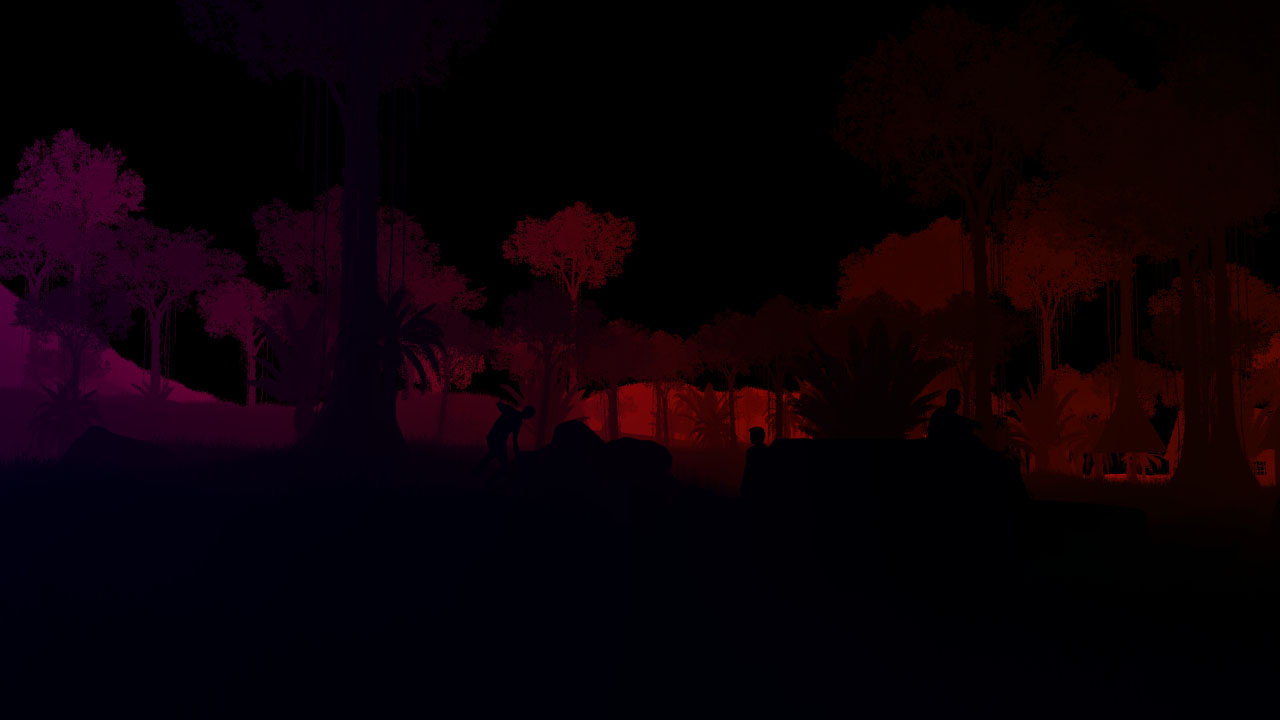

Never had to use the motion vector pass before this job as I was just using the beauty with the motion blur baked in it, and after spending few hours on the web, i'm hitting a wall.

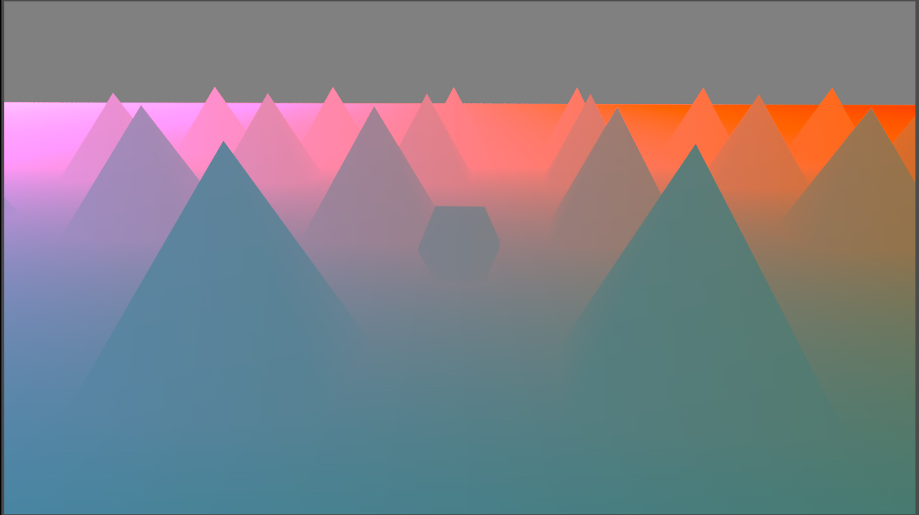

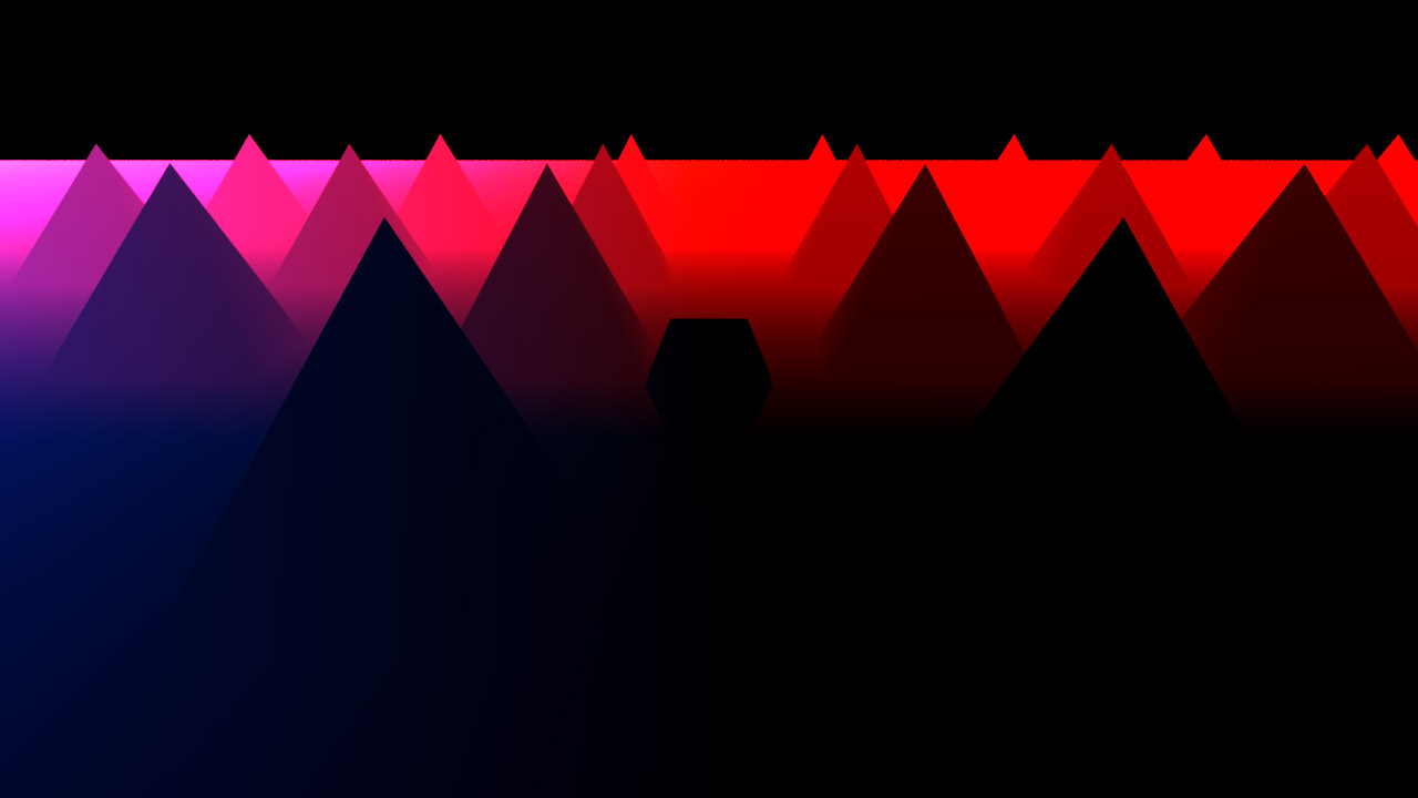

Octane produces an image with roughly blue to orange colors. As I understand it, it produce positive and negative values. It doesn't work out of the box with RSMB pro vector.
Anybody with a workflow to make it work? What am I doing wrong?
**** My workflow *****
In c4d/Octane :

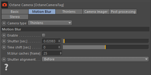

Activate the motion blur in the camera tag.
Set my shutter speed.

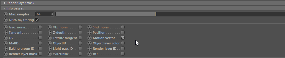

Activate my vector motion pass.
Result : my blue to orange image more or less intense depending on the speed of the camera move.

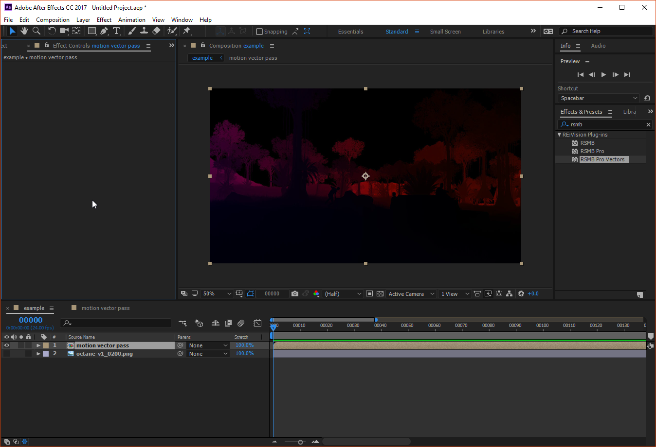

in after effect :
import my beauty pass
import my vector motion pass

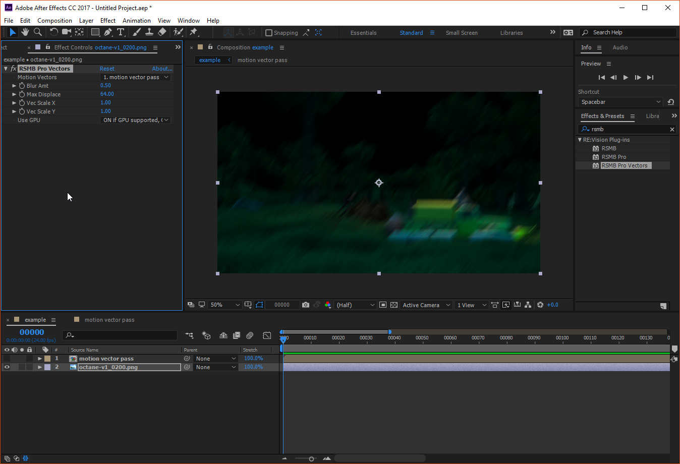

add rsmb pro to my beauty pass
link my vector motion pass in rsmb
Result : everything is blurry, not how it suppose to be
