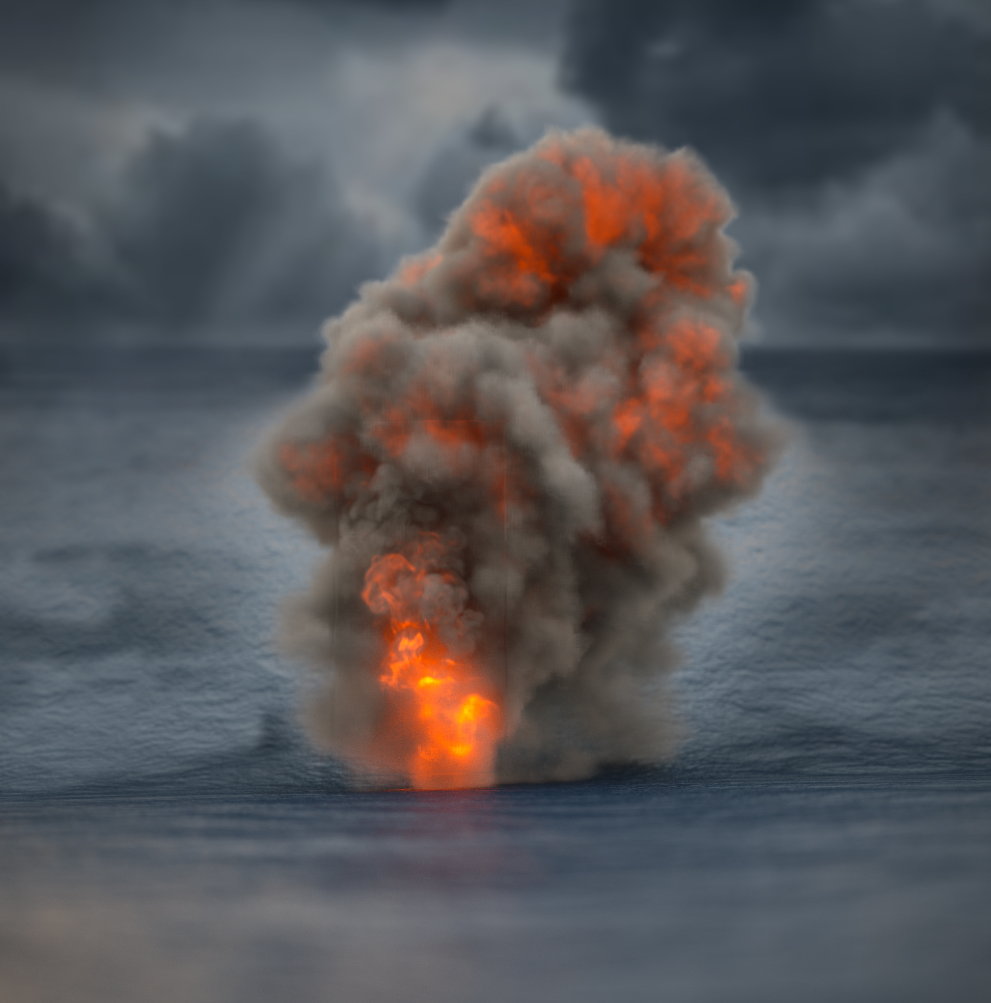

I am combining two VDB volumes and it looks like the smaller VDB bounding box region is showing through.
Any ideas what may be causing this?

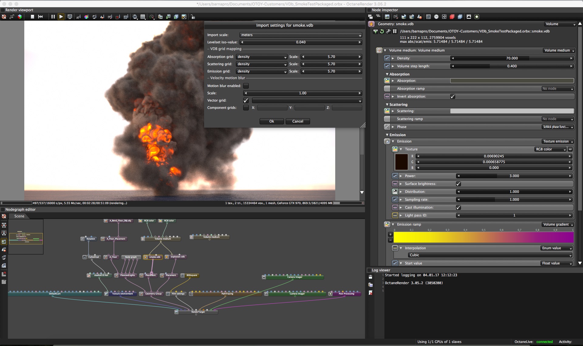

the two vdb files are differnt, one has the temperature grid while the other not.
I have changed the scale values to match the max values, I have also reduced the step leght at 0.4 and now the overlapping cube seems gone:
