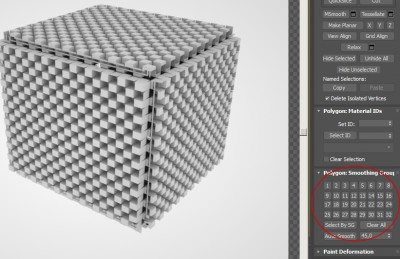

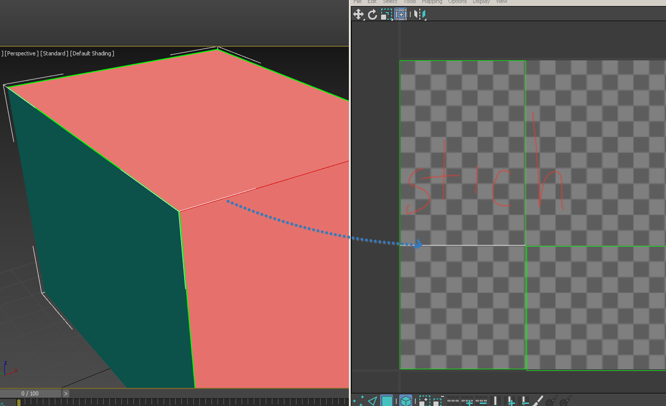

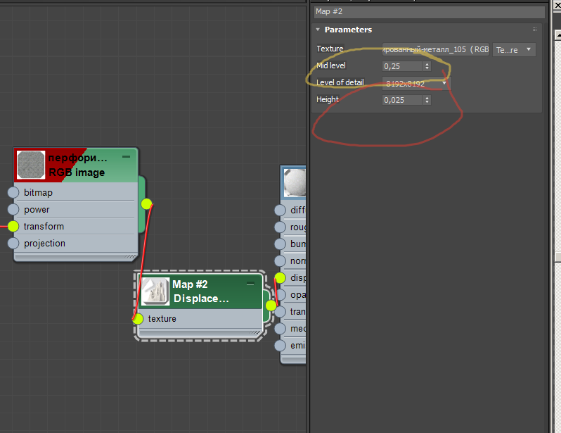

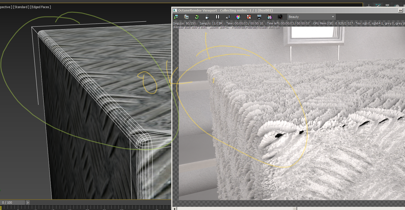

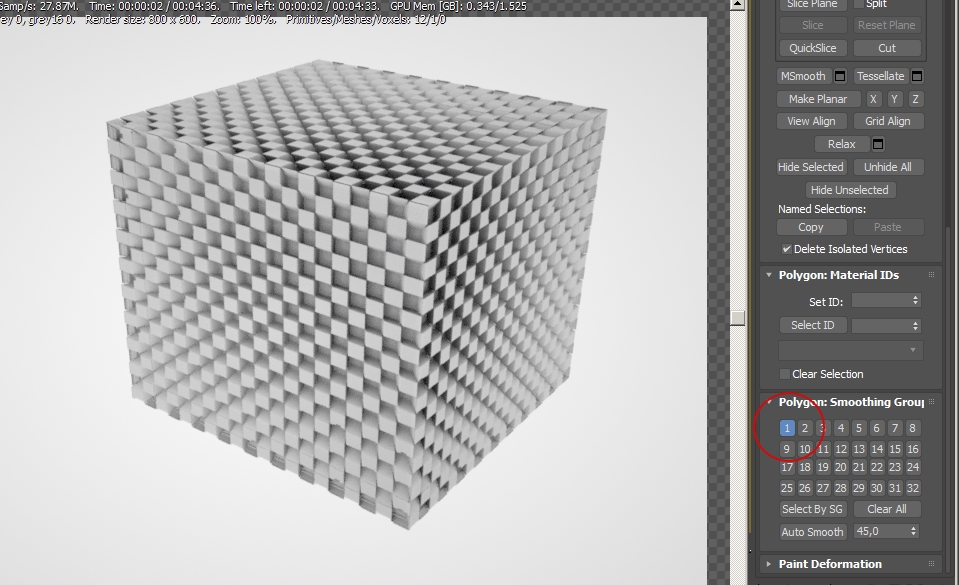

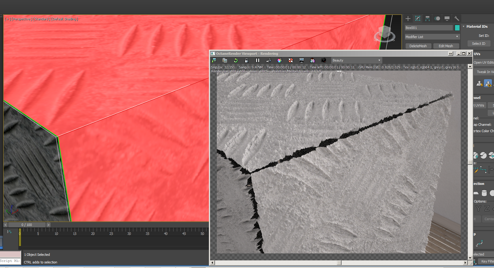

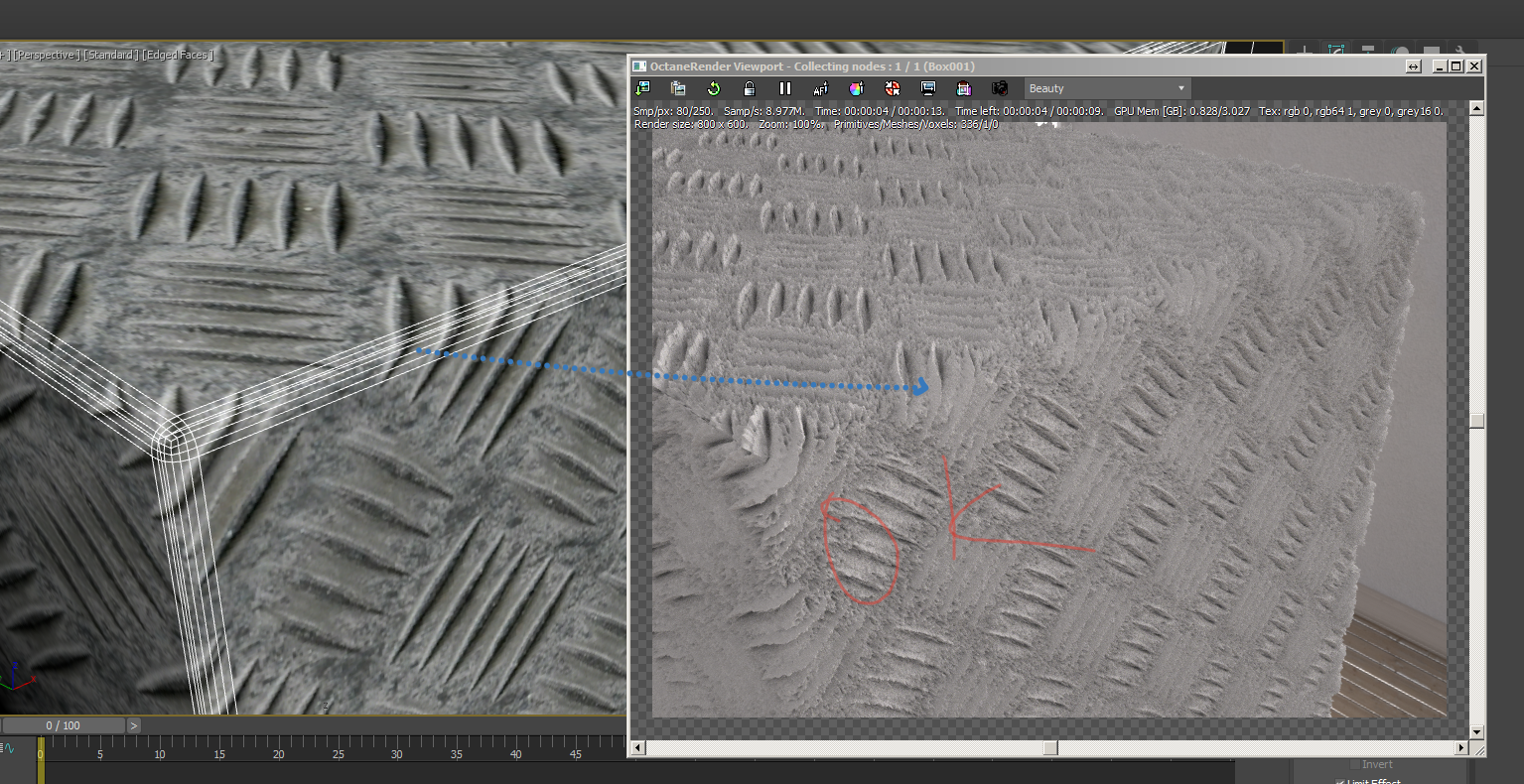

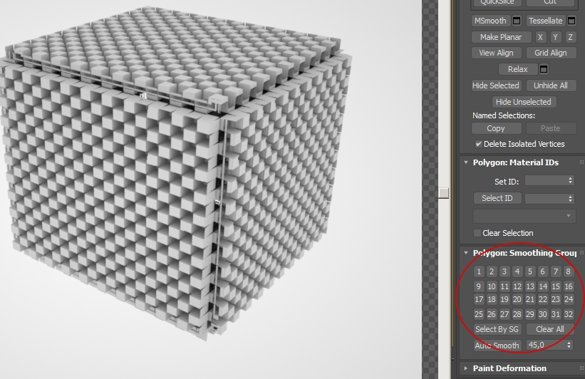

perhaps my answer will help if I misunderstood the translation I'm sorry ....
1.. 2.. 3... 4... add face on sharp corners
P.s. ( if the octane will solve the problem with the facets that I think will be solved by itself the problem and displays the map)

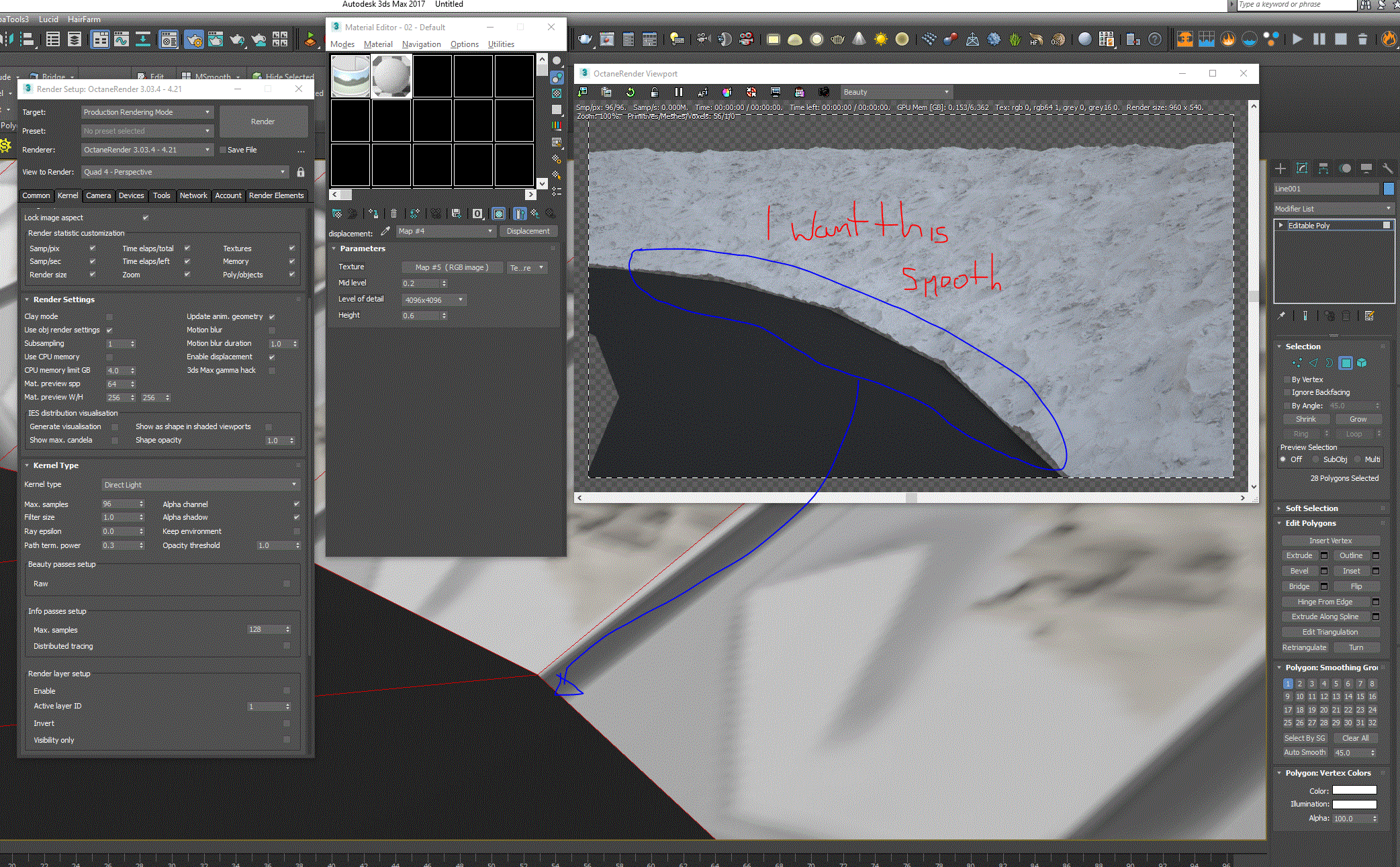

I didn't know about that trick..it will come handy in another job, however my issue is a different one..please see picture...
i have ONE object with 2 materials a road and a terrain...i would love to have a smooth transition...or if not possible..hard one would also work for my purposes...
