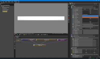

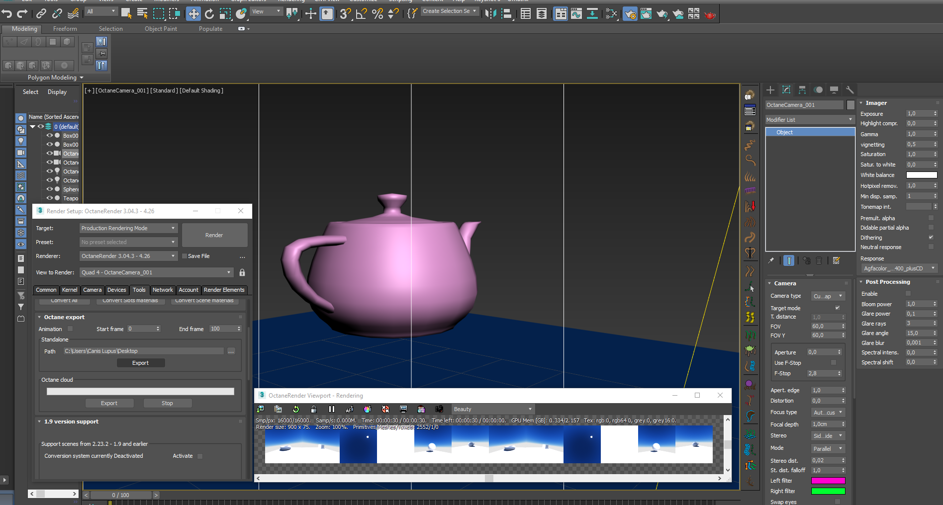

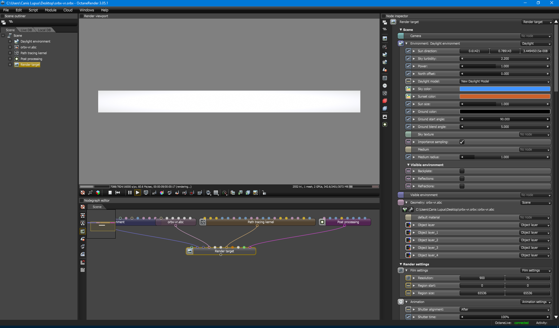

I have problem to export OctaneCamera cubemap to Standalone with ORBX.

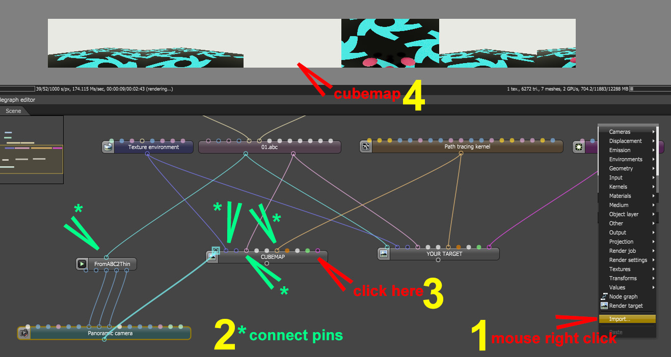

To solve this issue, I attached an Orbx with a Lua script (by bepeg4d) that you can import into stand alone.
Connect it to your scene like in the screenshot.
it correctly will render your scene.
You could export your scene without cubemap setting, so you will have both views.
I will point out the issue for developers.

This is an issue caused when 3dsMax exports to alembic format.
Regards
Paride
