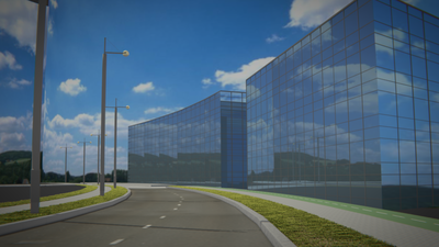

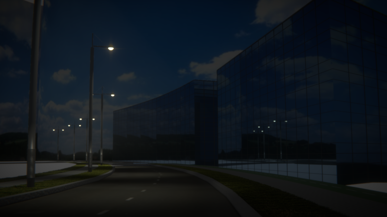

yoyoz, could you tell me how to do animation?
I have to light a lamp post but not as passing lights from blender to octane.
I put two example images. They are made ​​in blender.
Thank
Sorry for my bad English.
Win 7 x64 & debian | GTX570 | i7 3.4GHz | 8GB
yoyoz
Posts: 451
Joined: Sat Dec 25, 2010 9:59 am
Location: Belgium
I'm not sure about what you really want to achieve. Using latest blender version and latest plugin you can set a material to emitter and animate the power value (in fact you can animate all values).

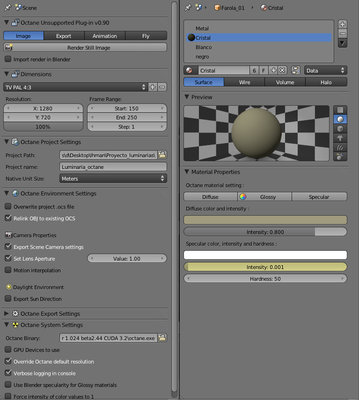

dmoya
Posts: 22
Joined: Mon Mar 14, 2011 12:32 pm
where I can download the latest version of the exporter?
this is what I have. I can not create material to emitter.
yoyoz
Posts: 451
Location: Belgium
It is in the plugin/blender subforum, v1.0x thread.
I strongly recommend you read the documentation first as you must understand the workflow before using it (and understand other constraints such as blender version to use).

dmoya
Posts: 22
sorry for the inconvenience. He had an older version of the exporter.
Now if I can make self-illuminated materials.
Thank you very much
