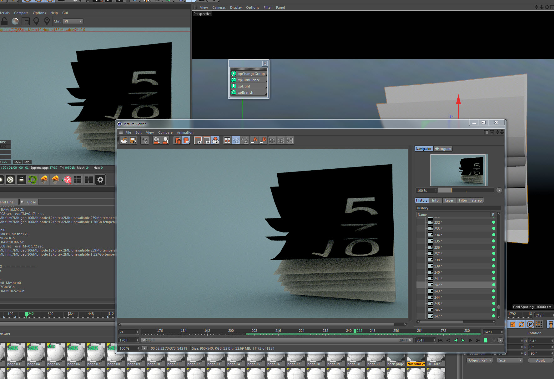

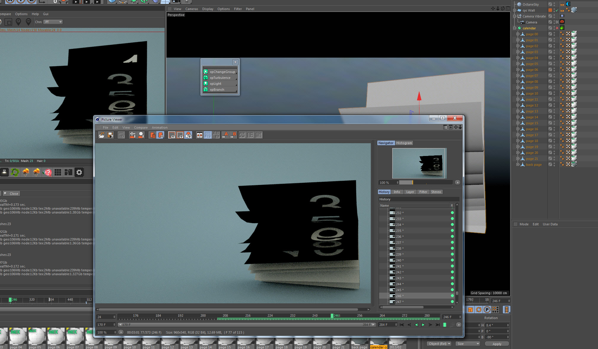

I'm rendering a calendar with a bunch of pages each side of each page showing a different month. Each page has a mix shader set to "side" so I can put different months on each side of the page. In the live viewer, everything looks fine. If I render "current frame", everything looks fine. However, if I render the entire sequence, the textures are not on the correct pages and the alignment is off. Scene was initially built in 3.04.3. I updated to most current version in hopes it would fix this, but it's still there.

Hmm... 170-542. I made it to about 235 before I came back and noticed the errors. And yes, that disappearing page has also been an issue. Can't figure that one out either.
