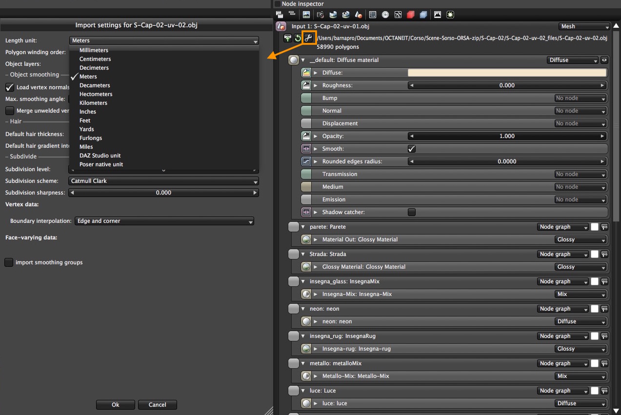

Posts: 10581
Hi Jorgensen,
to use a Placement node to correct the scale is surely an option, but it is better if you correct the scale in the obj preferences window:
or by changing the setting in Preferences/Import/OBJ:
Octane works in meter, so it has to be informed about the scale of your geometry.
Another solution is to export your proxy as .ocs or .orbx directly from Sketchup with the command Extensions/Octane/Export to .ocs-.orbx:
In this way the geometry will be already exported with the correct scale, ready to be used as Proxy in OctaneSU.
ciao beppe
