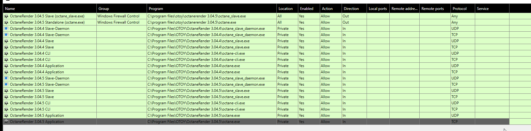

FYI, I run window Firewall control on the main computer (not on the slaves) with a medium filtering. I tried with this settings and with no filtering (firewall down) as well and I get the same results.
Win 8.1 64 | Geforce GTX780 x 4 | i7 5960X | 64GB
Posts: 10598
Hi and thanks for the video.
Do you mind to try again with the "Minimize net traffic" option unticked in the kernel settings?
ciao beppe
