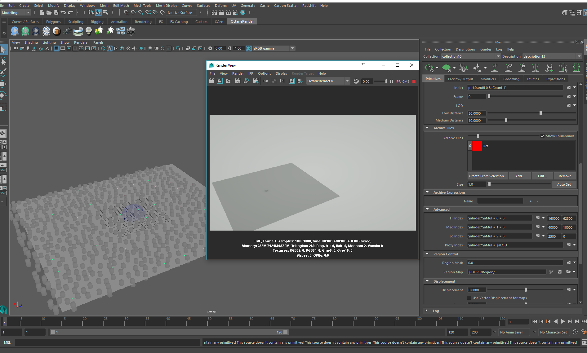

I am create Cylinder assign octane material and exported to archive (with any problem).
But after I add this archive in Xgen and it is work in viewport but on render nothing( why? attached image.
What I need do for render Xgen in render view?
What is problem? (Arnold, Mental support XGen - with any problem, and Redshift support (GPU render))
Please fix this issues. Because I am buy Maya octane licence only for use XGen!!!!

3dstarmodels wrote:Thanks Man! But I dont have skills with script ((
I have other question in support!
We don't have support for XGEN yet! the script is pretty easy if you need to use now for a project my advise is use the brave rabbit script, here a video https://vimeo.com/25777315
I attach the script is pretty easy and straight forward. Or use spaint3d https://www.highend3d.com/maya/script/sppaint3d I also attach the script here
with this script you can have the same feel as xgen painting. maybe could help to
If you have a lot time you can wait for a solid support on Xgen but I think will take time for the guys to make work.
Best,
JO
spPaint3D.rar
spPaint3D
(22.05 KiB) Downloaded 306 times
icPolyScatter.rar
Scatter
(6.63 KiB) Downloaded 306 times
Octane Render for Maya.
https://vimeo.com/jocg/videos
http://www.hmxmedia.com/

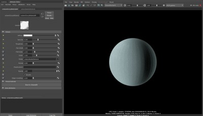

Hi.
I have a problem with the textures. The scene is simple; A sphere with a glossy material and a bump with marble texture. Any texture (procedural or bitmap) that is put in the bump gives the same result (bands in the sphere).
I have tried to re-map it, make a soften edge ... Nothing.
Please help.
Thanks!
