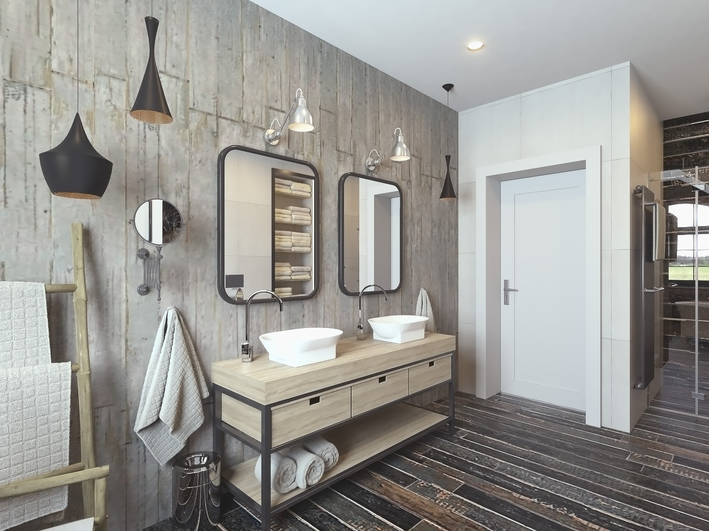

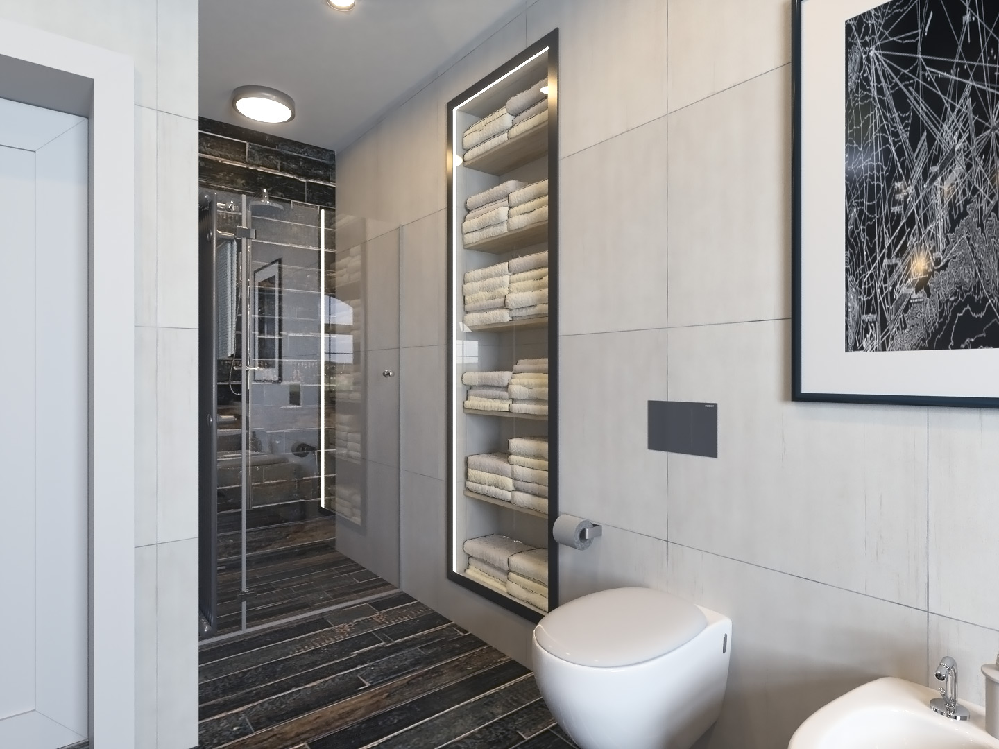

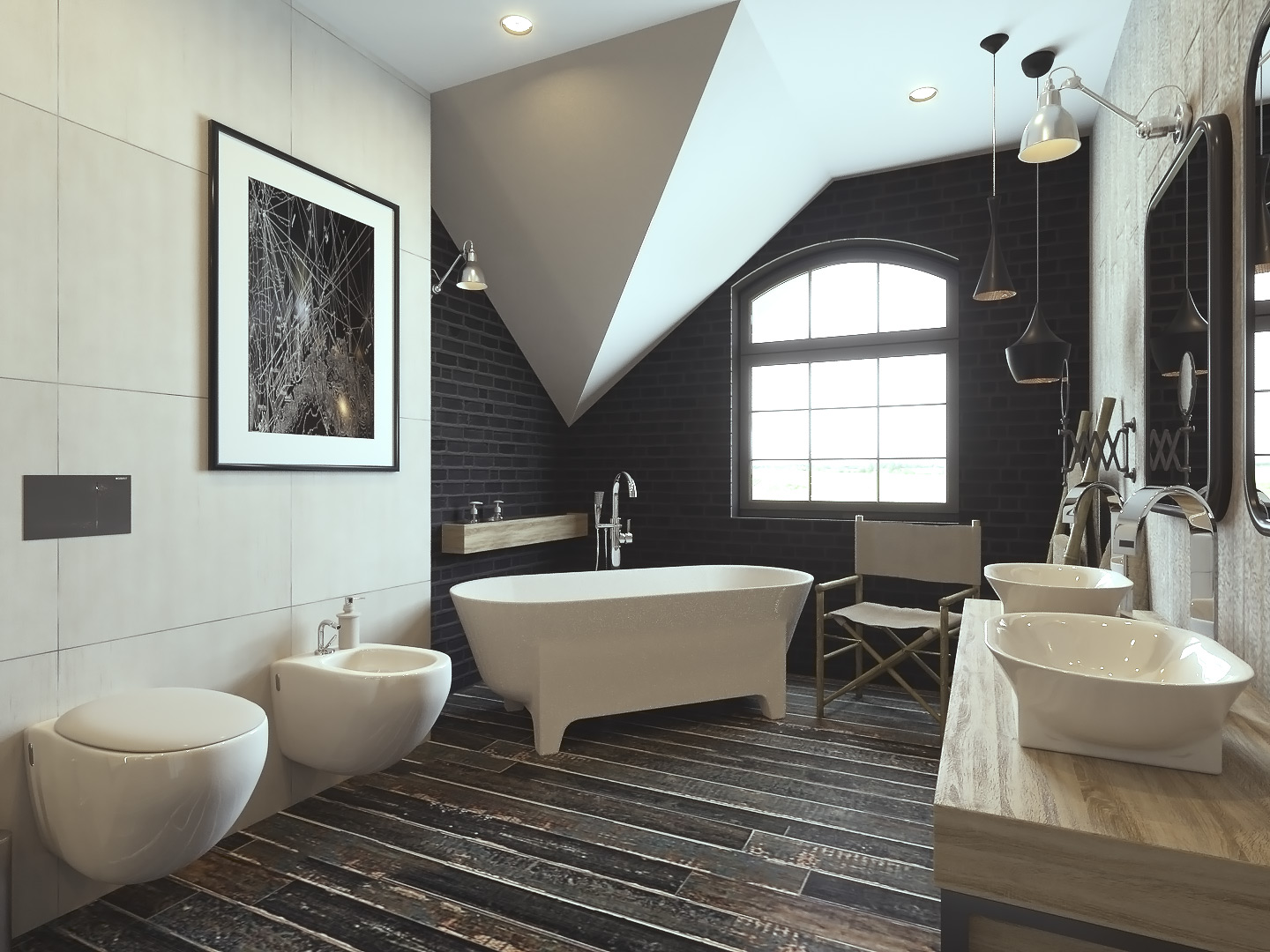

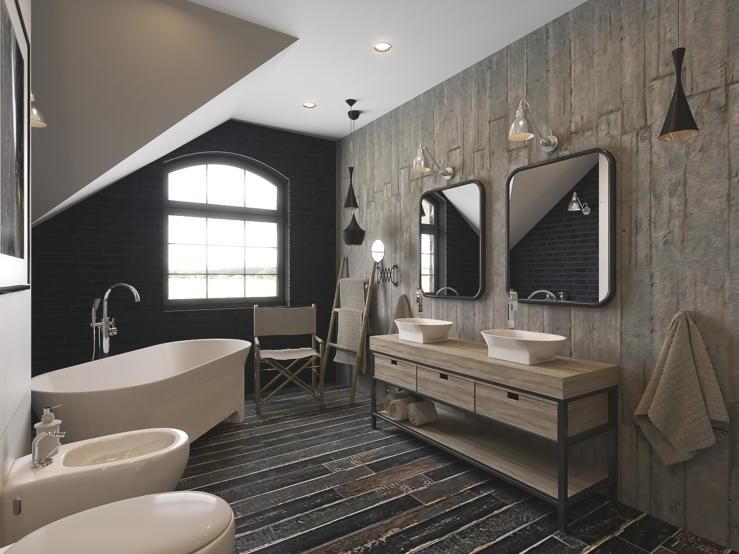

Hi
This is my first final render in Octane.
C&C are welcome.
Tiles on the floor and right side of camera have poor textures cause this manufacturer do not give any good quality textures for tiles.
							Bathroom - First render in Octane
first of all....nice design!
but:
1) floor texture looks to low
2) Your brick wall texture has no Displacement?
3)Your towels has some siplacement leaks--->Dark Outlinies
4) Your Wooden wall texture looks agly--->lowres?
5) U cant open your window......for details look at some pictures
6)u have no Base board
						but:
Hi
thanks for your comments and critic.
renderer was PT.
Most light from IBL and WindowEmitter Plane ( instead Portal ).
1) Yes - manufacturer has no better tiles textures - unfortunately
2) Yes, bricks only with BUMP
3) Towels in the shelf has low displacement ( or none ) as I remember
4) the same as 1)
5) Yes, I forgot the handle
6) we do not use baseboard when ceramic tiles are used ( all this what is on the floor and walls are ceramic tiles - it is not a wood but it looks like it )
renderer was PT.
4) the same as 1)
Be patient for me, please. I am new here.
