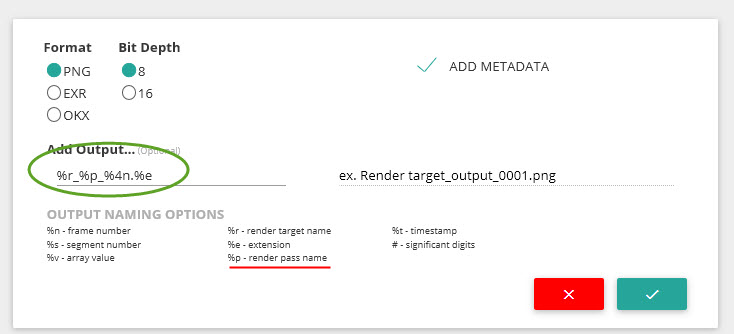

How do i render passes on octane cloud?

ringleader wrote:How do i render passes on octane cloud?

something like this?
%r_%Diffuse_%4n.96e?
What if I require passes from info channel as well?
Is it possible to set all the necessary passes in c4d and use the ORBX export function from the C4D plugin?

As how it write in image. It will render out all selected passes except object masks. Take some test drive on ORC to be sure. And check this page: https://docs.otoy.com/#cinema-4d-v3-plu ... standalone
