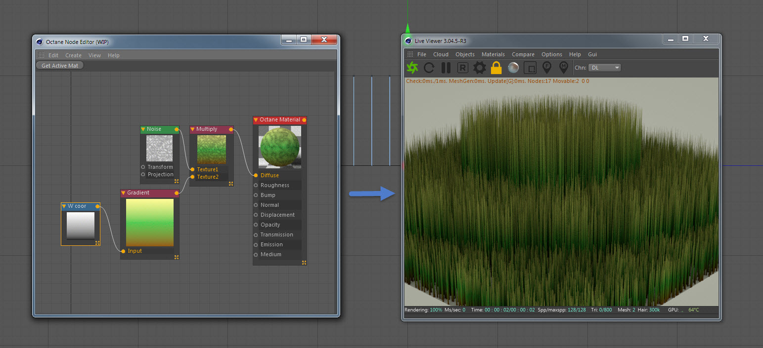

1. If you want to add a gradient to each hair you must use W Coordinate node on Octane shader to work properly, and it works, so you can archive something as the grass photo in this thread.
