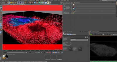

You guys know that Cinema4D natively don't have so good features to simulate particles. So people using other softwares like Houdini, realflow, etc just for simulating particles and bring them back into Cinema4D through Alembic. So after importing particles back into C4D ppl can't render them using Octane, nothing surprising, cuz Octane doesn't support Alembic particle type, thats sad.

I have attached .abc file with particles simulated in Realflow 10.aoktar wrote:As fulltime developer that's hard to learn another softwares. So it would be great to see a few sample scenes for your usage.
Just import them in c4d using that settings:
You will see the particles in viewport.
When importing particles in empty scene im using scene scale as 'Meters' or particles will be very small.
Also im using import points 'As Polygon Object' cuz another option is Thinking Particles or something like that, i dont know anything about this option.

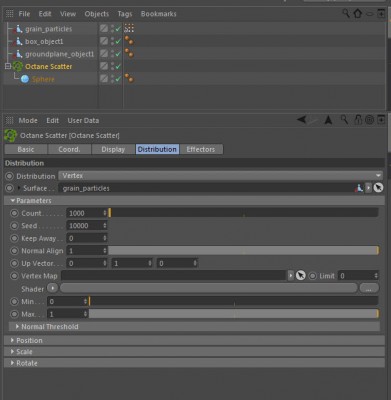

Please follow your posts in a shorter timerange! I have a lot of topics to follow while working on plugins.jmd wrote:Hi, any update on this? Scattering help to control the size of particles but can't get that color data to work (plugin in vertex map houdini color data as diffuse)
Could you please send your latest test scene with alembic? I'll check it.
